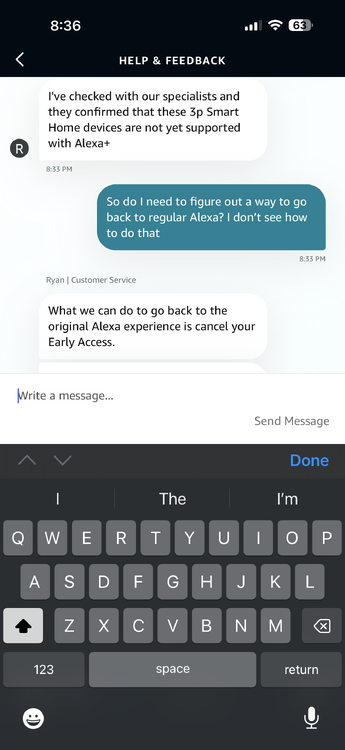

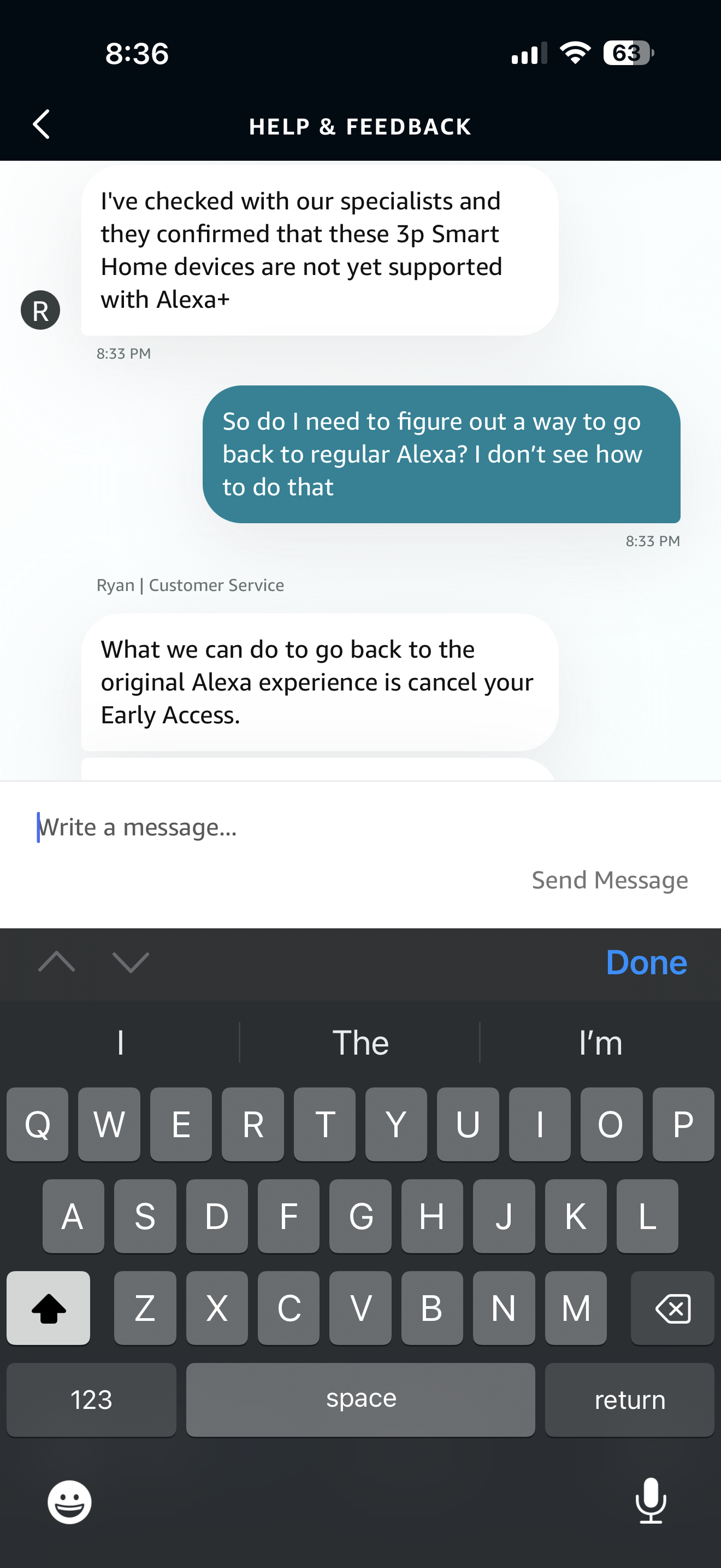

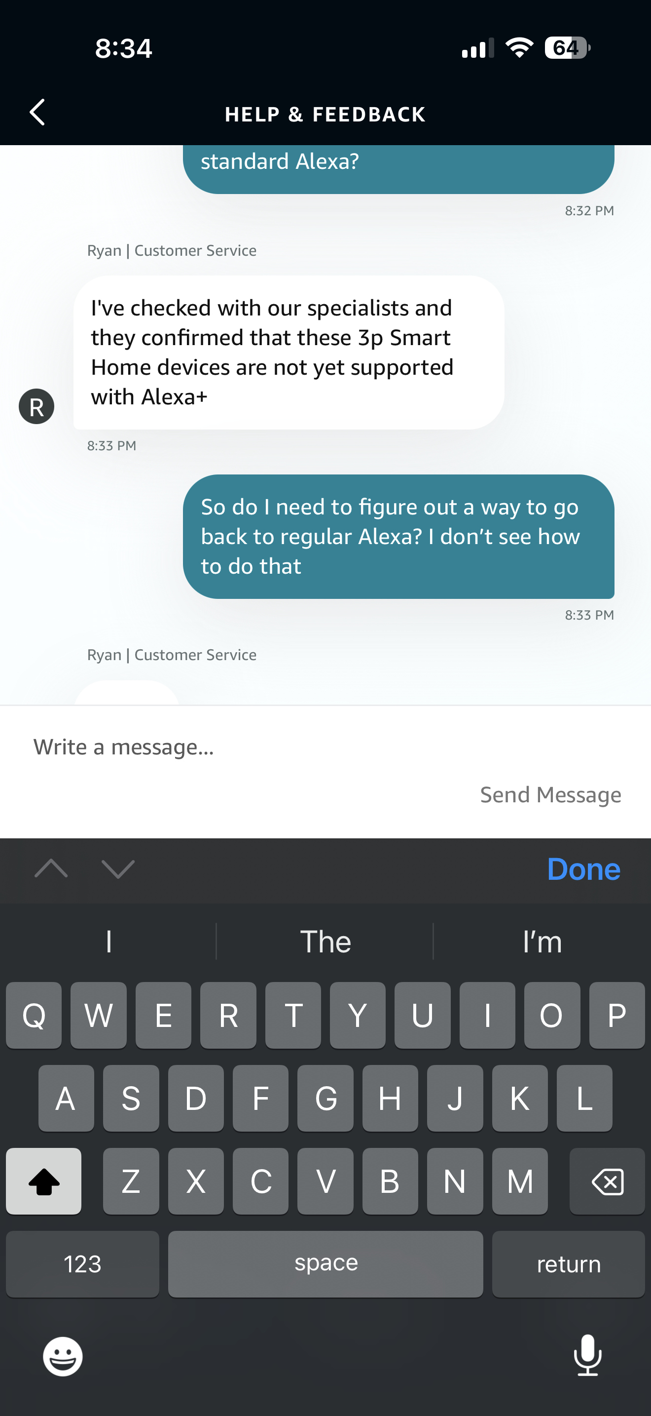

I have some new information after talking to Amazon customer support. They said there are many issues using Alexa plus with the ISY. The best way to recover is to go back to standard and you have to get on customer service to ask them to remove Alexa, plus.
See attached pictures
