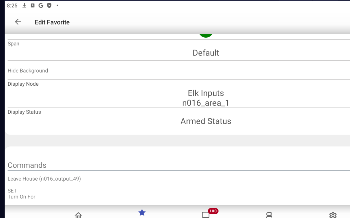

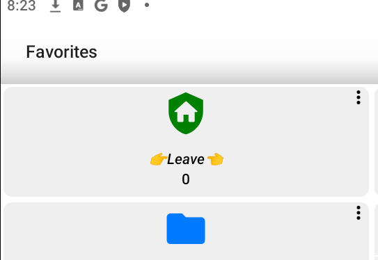

After upgrading to OS 14.3 & IoX 6, status labels in the ELK plugin are shown as numbers and not the corresponding text in UD Mobile and eisy-ui. Status labels are shown properly in the Admin Console(Java). I’ve also noticed that the ELK plugin disconnects and then reconnects when viewing the plugin in UD Mobile under Settings and logging into eisy-ui.
