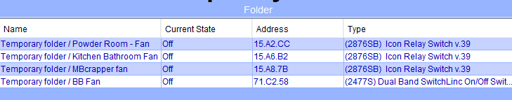

I am still working on this, in my spare time. I am still finding devices turned on when ISY thinks they are off. This has been happening for years, really. I previously figured that my ISY/Polisy/Eisy this was just a communication issue: the ISY would try to turn the device off and the device just didn't get the message. I am now noticing that they are on when it seems that no one (and no program) actually turned them on. as I look into this further, I find that they are all similar devices with similar Insteon Addresses:
of note, the one called "BB Fan" is one that I swapped to a new switch and it hasn't happened since. My current thought is that something is sending an on to them and I haven't been able to confirm what it is yet. I theorize that it is an alexa, but I also wonder, although seemingly extremely unlikely, that it could be a miscommunication through the REST system. the reason I believe this is because of the similarity of their addresses.
I made some programs to occasionally check the devices for being on when the Eisy thinks they are actually off and then I'll look in the "Error Log" as suggested above by @kclenden and see what I can figure out.
any other thoughts?

My kneejerk reaction is that this is (again) alexa commanding your devices on using the rest interface. The event viewer posts that you have made showed a rest command instructing the EISY to turn on the device @48.15.F2. That's a very specific device direct command. If this is still occurring, you should be able to view with the event viewer and the EISY log.
I am not Alexa knowledgeable. It's possible that when you upgraded your BB Fan device you also eliminated the link in Alexa.
I do use the rest interface extensively between my ISY994 and Home Assistant. I have not seen problems with miscommunication and am not sure what that would look like.
My last comment relates to the age of your Insteon devices. The are older Icon powerline only devices (I still have several). I did get tripped up a while ago by a light that began responding to an X10 command (2876S V.28 Device). I still have some X10 floods that activate and announce motion. My driveway flood began turning the icon device on/off. The ISY994 was completely blind to this. A factory reset/restore eliminated the X10 address in the switch.
The ISY does not (to my knowledge) give us a way to check whether devices have X10 addresses programmed. It's kind of a blind spot and the reason that I bring it up. For years protocol dictated that you factory reset every device out of the box to prevent X10 addresses that might exist from factory programming.
Having said the above, it would be extremely unlikely that you happen to have 4 icon devices with X10 addresses programmed. If you suspect this is the case, let us know. They are ways of testing using x10 all-on house codes.
That sounds correct. The ISY will not show an X10 address in a module. If there is an X10 command it should show in the log or if active in the Event Viewer.
