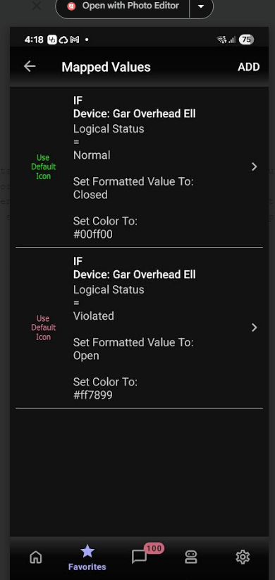

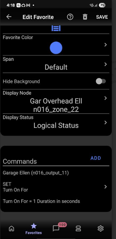

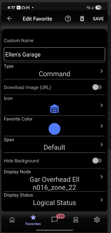

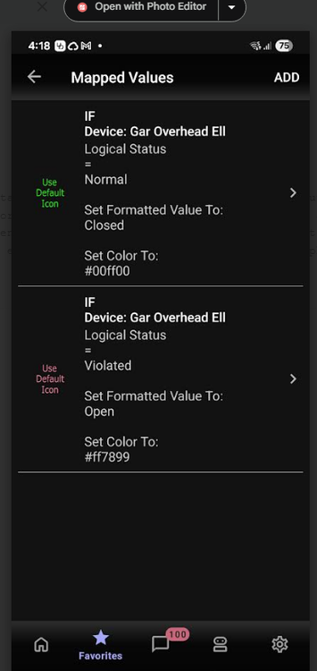

I have an Elk alarm that I physically wired the relay into the garage door opener, so if I turn the Elk relay on for 1 second it is like pushing the button for 1 second.  An IO linc would work the same.  This is how I set it up.  I also set the icon to be green when the door is closed.  Hitting the button on UD mobile is the same as hitting the button in the house for 1 second.  I do not have a "close" and "open" button because they don't work with garage doors that are already in motion.  If the door is closing, it will still register as open.  I suppose you could put a delay in that waits for however many seconds your garage door takes to close before testing if the door is closed, but then it will delay every time you try to close the door.
