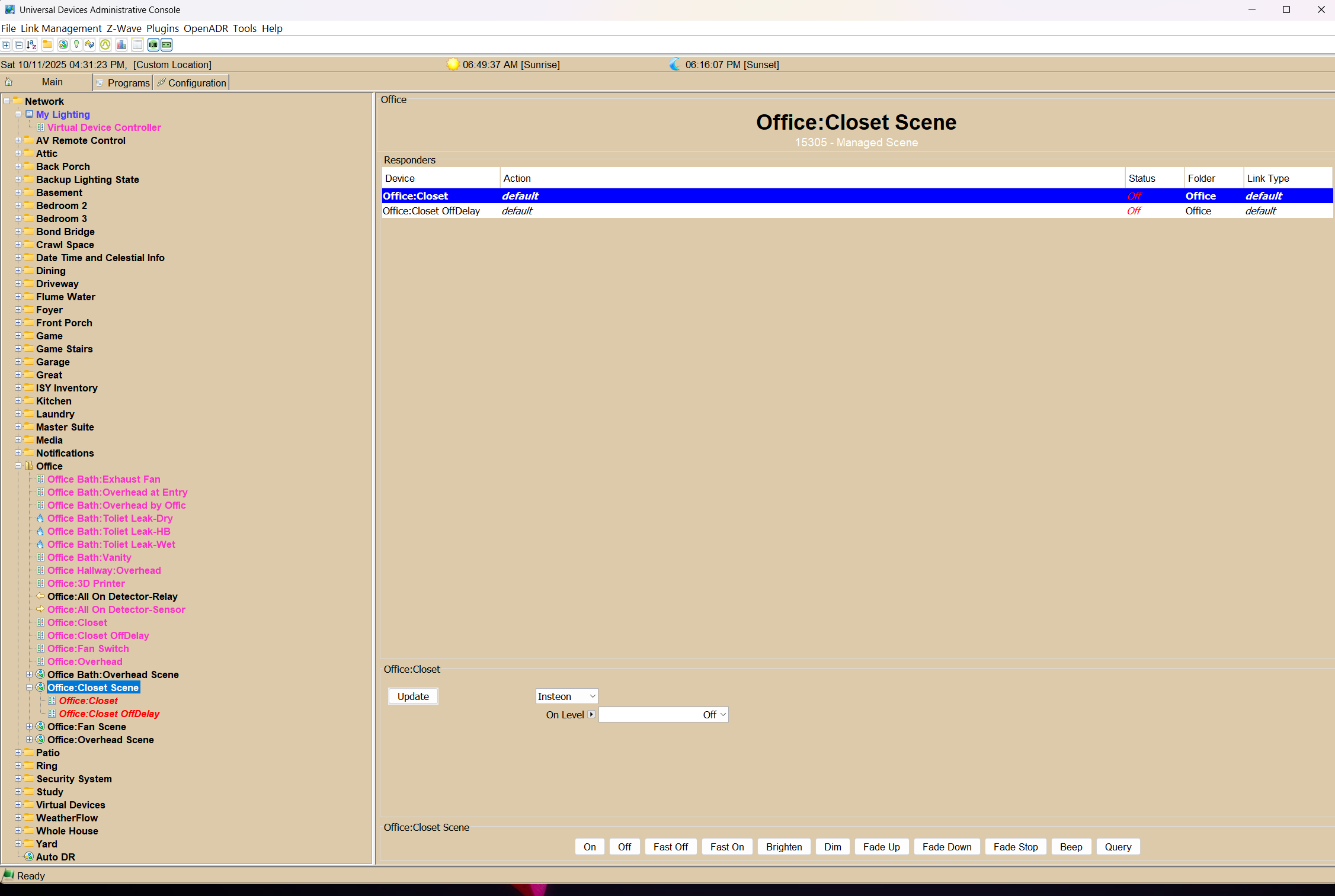

@sjenkins Thanks for taking the time but I do not have those options regardless of what I'm clicked on.  I'll research more and may post more images in future.
I 100% understood scenes and their devices and scene level hierarchy when they were pure scenes and all my more complex scenes were created then so only had to replace a couple devices to keep it going. I haven't thought about scenes / groups definition detail in several years.  I guess with v5 FW is when the Group concept came in to being that gave many more capabilities with a single scene/group but was not as straight forward.  I've been looking for concise documentation this morning on groups/scenes and can't locate anything that doesn't have discrepancies with actual gui screens.  Therefore, I'm going to create another post describing how I understand it to get a point to better / accurate documentation that I likely missed.
If you have scene with 1 physical switch and one offDelay virtual switch:
  • Turning on / off at the  physical switch does what is expected
  • Turning on / off the screen from AC or UDM does what is expected
  • Turning on / off the physical switch device inside the AC or UDM does not start the timer   - is this the expected behavior

I created the scene and added both physical and virtual devices as controllers and both show ed up as red in the scene. However, after reading your reply, to be certain I looked at each device. The physical device showed it as controller and responder for the scene but the virtual device showed only as responder to the scene. I removed virtual device from the scene and added it back as a controller but again when I looked at the virtual device it showed only as being a responder to the scene. Next I deleted scene and started over. Same results.
Sorry if I didn’t say it very well but if I turn on the physical switch device using eISY AC, it did not start the timer and hence did not turn off the light after defined delay. Not sure if it’s what you would expect so wanted to point it out just in case and compound that with scene definition I found looking at what you said.
Yes, scenes / groups are great but to me they are described structurally instead of how to effect them through the AC UI. I wrote what I understood and asked for comments in a general eISY post.
@hart2hart,
something odd with the Controller adding as a Responder. Only thing I can think off is the profile didn’t take. You may want to reinstall the plugin. And / or reboot the eisy.
I can add as responder or controller.
I would say this is expected, scenes are not triggered when you operate a device from the AC. You can test this with any scene you have only the device you operate from the AC responds. I think because ISY does not receive a command from the switch when it is not manually operated.

You are right, about inside the AC & scene triggering. @hart2hart, you are right, I misunderstood the first time.
