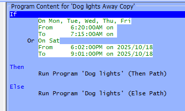

Trying to figure out why a program isn't running
This is the program I have. The Then path of "Dog lights" turns on 4 sets of lights. The Else path turns them off. The program does not work?

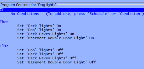

Here's the "Dog lights":
The lights did not go on at 6:20 am and did not go off at 7:15 am on a Friday (today).
Any idea why? Thank you.

Is the program disabled? We cannot see that parameter unless you copy to clipboard and then paste the program into the post.
Right click the program title and select "Copy to clipboard"
Dog lights - [ID 0048][Parent 0001]
If
- No Conditions - (To add one, press 'Schedule' or 'Condition')
Then
Set 'Deck lights' On
Set 'Pool lights' On
Set 'Deck Eaves Lights' On
Set 'Basement Double Door Light' On
Else
Set 'Pool lights' Off
Set 'Deck lights' Off
Set 'Deck Eaves Lights' Off
Set 'Basement Double Door Light' Off
Thank you. That's it above. There is a red mark on the left side of the icon for it, but we use this all the time via Alexa/Amazon Echo. It's not set to run at any time, though.
I don’t think you need the separate Dog Lights program.  You could just put that logic in the Dog Lights Away program.  But that’s not the problem.  I think it’s the IF statement.  The Mon-Fri section has no calendar entry and may be halting the program from running. If you meant to trigger on Mon-Fri all the time then check the “Daily” box when programming that part of the schedule.

Well, I have the Dog lights program to turn on/off the 4 switches for outside lights. I've had 5 switches, and I'd like to keep that option open too, and maybe even 6 switches is a possibility.
I have this program and another that use the Dog lights program. So, if I don't have the dog lights program, and I want to change the dog lights to add/remove lights, I'd have to do that in multiple programs instead of one.
Doesn't "daily" mean every day? Or does "Daily" mean something else? I just want m-f for now.

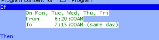

@slimypizza is correct - This program is wrong. You have "on" but nothing after it. You've unclicked the "daily" button and it's trying to do it for a specific date, but you've apparently removed the date.
Like how you have it: 20251017-program-not_daily.jpg
What you would expect to see: 20251017-program-daily.jpg

Thanks, daily does work. I had interpreted "daily" to mean every day, and I think it means whatever days you've selected and not the scheduled days.

As long as I can remember. It is kind of an oddball option (IMO) since automation is ongoing; when you uncheck it the program looks for a specific date. It is checked by default on new programs (like "All"). If you uncheck "daily" it looks for a specific day for the program to evaluate on. Leaving it checked allows it to run "daily". If you uncheck "All" then you can check the specific days of the week (if you had a M/W/F schedule you would just select those days, but still leave "daily" checked so it ran every M/W/F.
