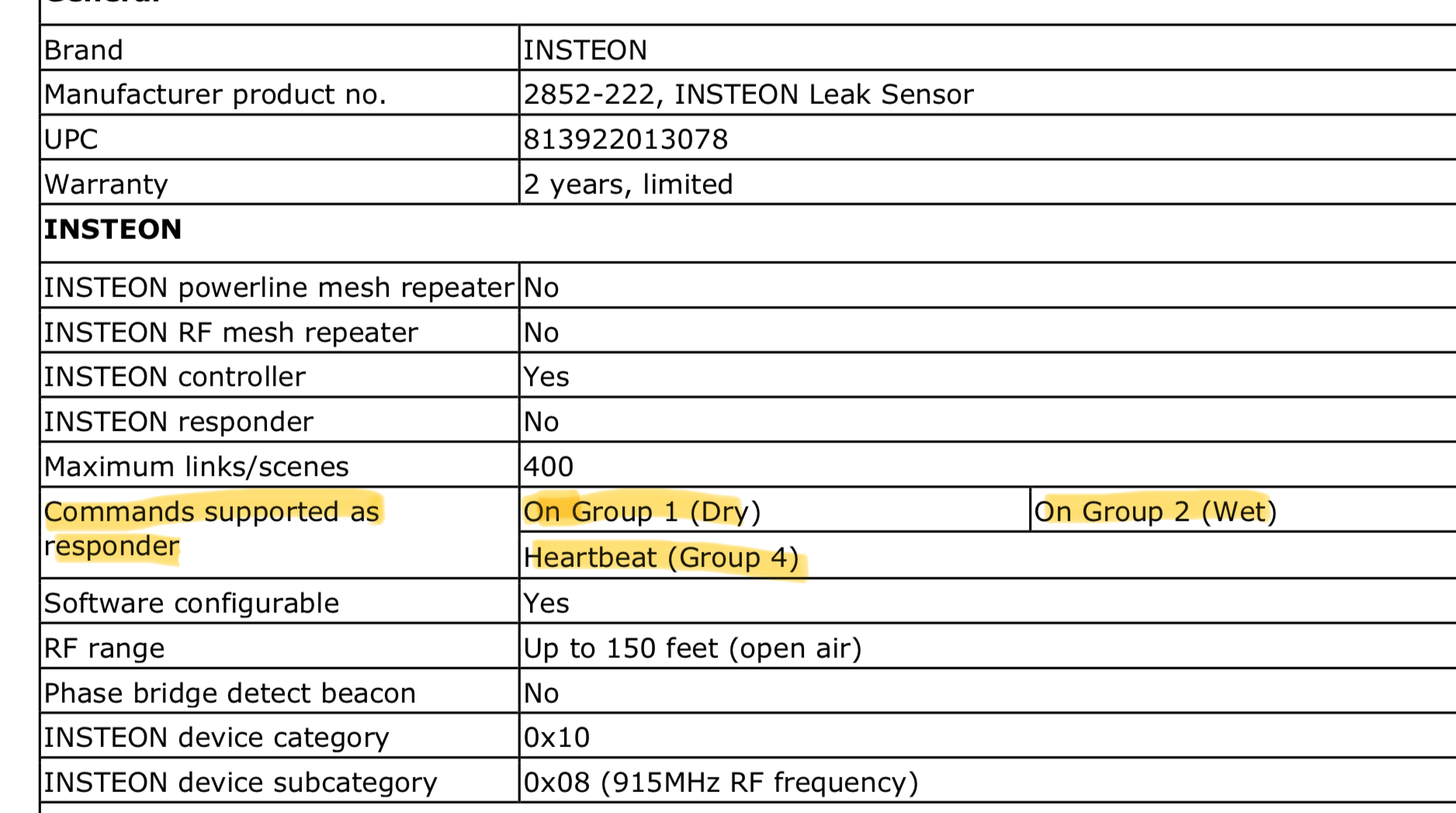

@haroldunger Think of it as one device that has three nodes.
XX XX XX 1 Is the dry contact
XX XX XX 2 iS The wet contact
XX XX XX 4 is the Heartbeat
XX XX XX is the Insteon address of the Leak sensor...
