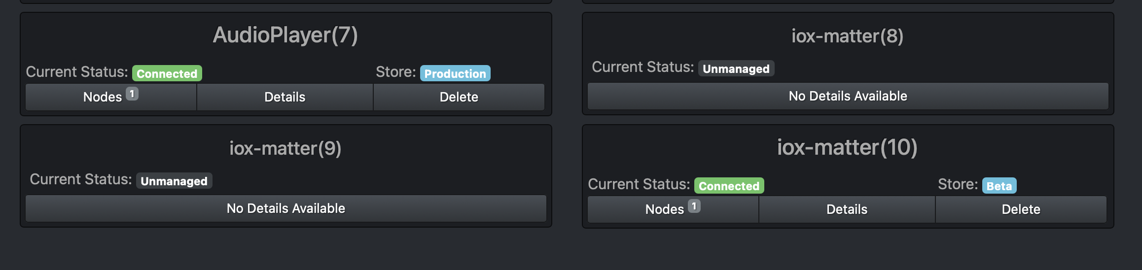

Hi,
In PG3 dashboard, i have iox-matter plug-in is installed 3 times. Only one seems to be active, but I can't delete the other 2. Is there a way.
Thank you in advance.
@francoislegacy since they show "unmanaged" in the PG3 dashboard there's no way to do it there.

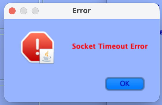

Thank you Geddy for the detailed explanation. I followed to the letter, but sadly it didn't work.
When I click delete, the Admin Console answer with a Socket timeout Error.
