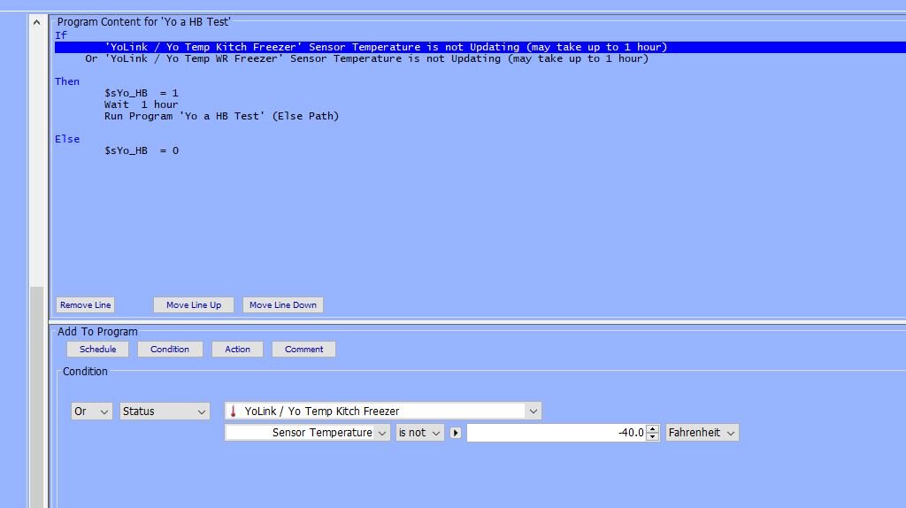

I think there is an issue with temp sensors suddenly on my system. This worked in previous versions. This is an old program I set up.

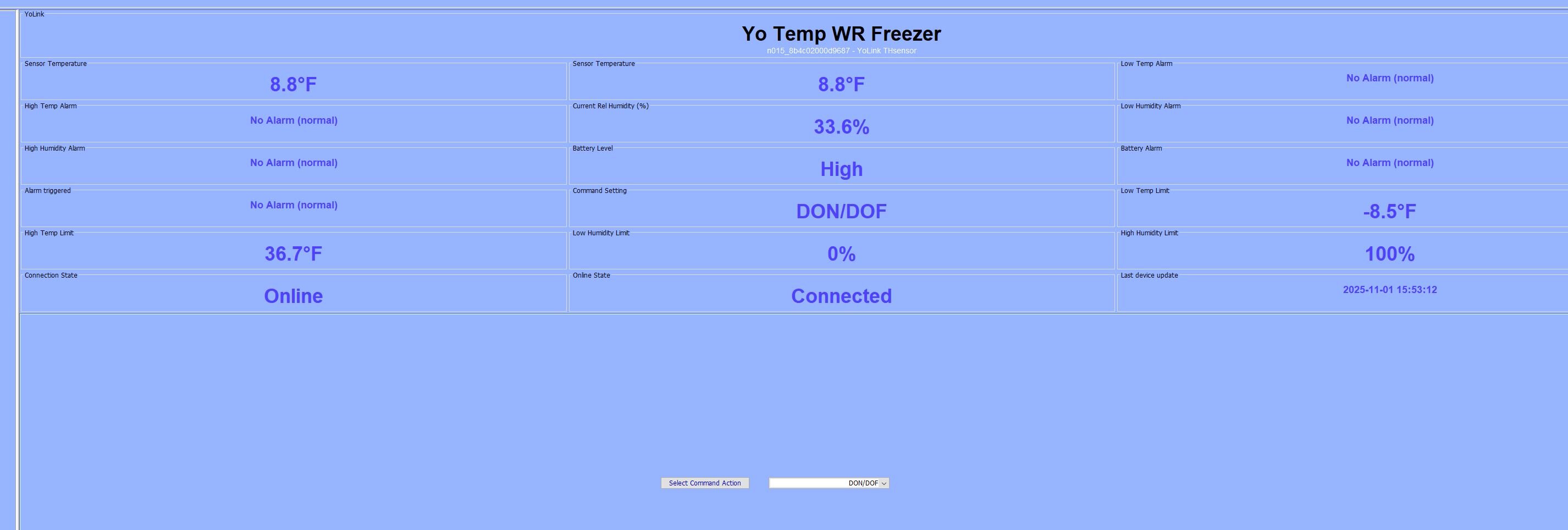

I was checking to see why the program was not running. The program used to have temp of around -40F but not the program displays, well take a look at the pics. The second picture shows the actual values but at the top it doesnt.

I think there is a bug - somehow the unit is not changed even when I specify it - I will have a fix in the next release - it is something in the updated console program (my guess) that requires a different handling than before - there is also an issue with F and C they way I have handled in the past
Are you really having temperatures down to -40f - I have that as a minimum for the temperature - do I need to support lower than -40 - Not sure the sensor works that low

@Panda88 Lol, thank goodness, no. Back in the day, early on I was using this program as a heartbeat for the plugin so I selected the lowest temp possible. But now I see, at some point, you added Last Poll Time for the plugin which I have now switched over to use as the heartbeat (thank You). But when that program fired and alerted me the heartbeat was down is when I discovered that the temp nodes in programs were wacky.
