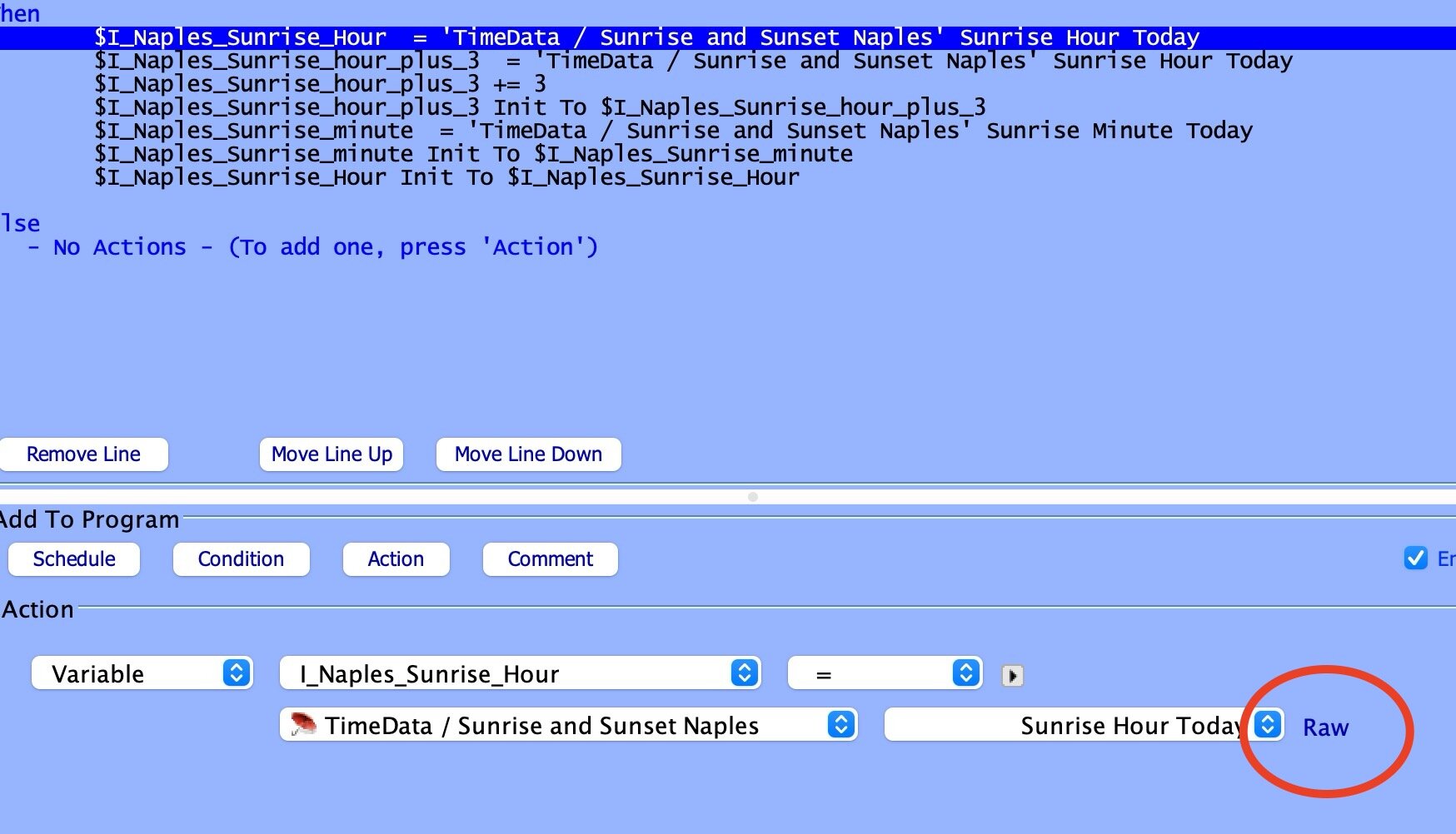

Solution was to go to each reference line in my programs and hit "update" as the format changed from Minute or Hour to Raw.
Previously this was "minute" or "hour" and in the program line, it ended with "minute" or "hour". After hitting update the "minute" and "hour" went away. Programs now work again.
