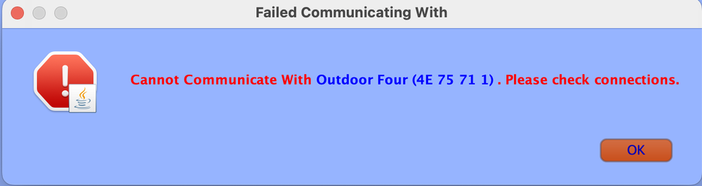

Voice commands, commands from the guy, and app do nothing.
I get this pop up.
I tried restoring one of the devices but that didn't work either.

I've brought them in the house for testing and they still don't respond correctly. I tried changing the problematic ones to 'contact sensor' and Alexa just said it didn't support that. When I tell Alexa to turn them on as lights she says Okay but the error pops up and nothing happens
