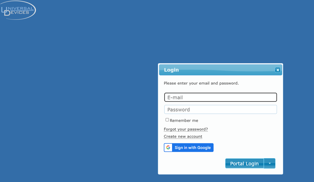

I selected update, which it did, and now I can't log into the Eisy from IoX launcher. It does not seem to know my username or password (probably password) any more. I can log into it using the user name and password with eisy.local

Does the login box say "use your IoX login name and password". If not, does it ask for your portal login (email) and password ? Just make sure you're using the right ones

If the IoX launcher is showing v6.0, you need to use your portal login credentials.
I am confused. Maybe I don't understand what the "portal" is. I thought that was where I had additional add-ons setup and I've navigated to that information from within the UD program launched with the icon. I am not aware of a separate username and password for the "portal".
So I guess the question is how do I reset my password in the "portal".
Thanks, Confusion gone. I figured out (fount) the portal user name and password. Why the change?

The portal address is: https://my.isy.io/index.htm
This is a UD website that allows exterior connection with out opening ports and additional services. It is a paid subscription for a nominal fee.
UD is moving to single sign on for all services.
