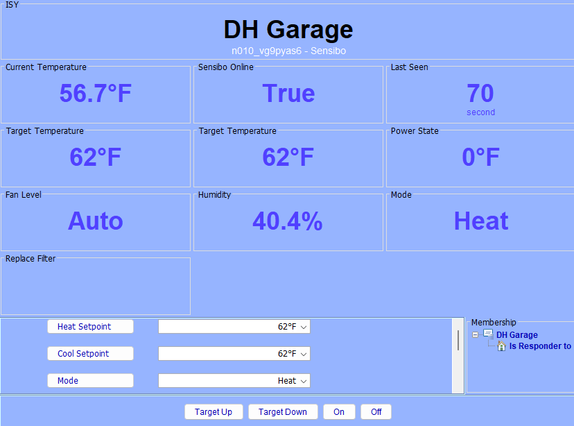

I noticed that the temperature in the space dropped below the setpoint in a program to trigger heat mode, but the unit didn't turn on. When I signed in to the admin console, the none of the Sensibo nodes where populating.

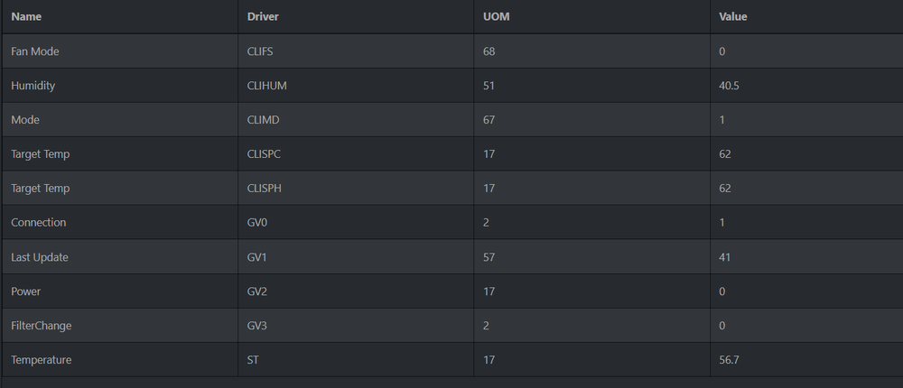

Next I checked pg3x and while the configuration screen looked fine, plugin wasn't responding and the log didn't populate. I reinstalled the plugin in the same slot and everything came up fine. However, I noticed the Power State in the admin console was reading 0 degrees F. In pg3x the Power State is listed as GV2 and a UOM of 17, which is used for other temperature settings.
Turning the unit on, the Power State updates to 1 degree F.
Something appears incorrect?

I did a comparison of the UOM values listed in sensibo_node.py and pg3x, besides GV2 showing 17 instead of 25, I also found the following discrepancies (clarification - I compared UOM values from github to pg3x):
CLISPC - pg3x UOM = 17 instead of 4
CLISPH - pg3x UOM = 17 instead of 4
ST - pg3x UOM = 17 instead of 4

Here are some screen shots of what I see.

Thanks for the information. I did find the following in the debug.log:
2025-12-04 11:40:24.373 Command udi_interface.node DEBUG node:setDriver: vg9pyas6:DH Garage Reporting set GV2 to 1 to Polyglot
2025-12-04 11:40:24.373 Command udi_interface.node DEBUG node:reportDriver: Updating value to 1
2025-12-04 11:40:24.383 Thread-1 (send_thread) udi_interface.interface DEBUG interface:_send: PUBLISHING {'set': [{'address': 'vg9pyas6', 'driver': 'GV2', 'value': '1', 'uom': 17, 'text': None}]}
2025-12-04 11:40:24.414 MQTT udi_interface.interface INFO interface:_message: Successfully set vg9pyas6 :: GV2 to 1 UOM 17
I will pm you the full log package, if you could offer me some direction, it would be appreciated.

I suspect that something (IoX or PG3x) is saving the UOM values and unless something actually changes them back, they'll stay that way.
I faked the creation of a node (since I don't have an api key) and the plug-in created the node with the correct UOM's and the admin console shows the node correctly as well.
You can try first just deleting the node from PG3x. When you display the nodes for the plug-in, you can click the [X] button under Delete on the right and it will delete the node from PG3x. Restart the plug-in and it will recreate the node.
You may also have to delete the node from IoX but that may mess up any programs that are using that node.
And it appears you are correct. Deleting the node and restarting the plugin corrected the problem.
