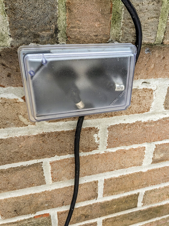

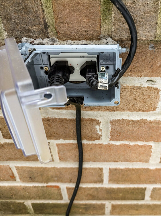

@paulbates I'm not an electrician, but I think it's good practice to have any outdoor power cord coming from above an outlet do a 180 degree bend below the box before entering the box, so there's a low point for water to run off. Perhaps you don't have a long enough run to allow for that, but if you do, it might be wise to add it.
