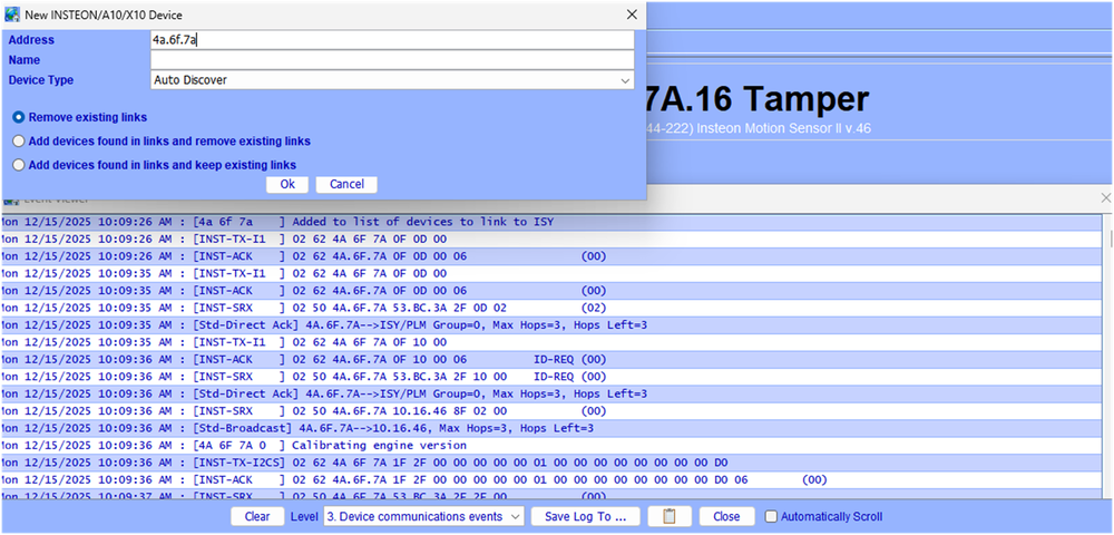

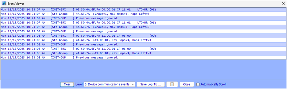

Another possible check - If your MSII has been linked to the PLM previously, it will still contain the PLM address (even after a factory reset). Assuming the PLM still contains your MSII link (hasn't been restored from backup), you will see the MSII address pop up in the event viewer when you apply power. The communication below is from my MSII @4A.6F.7A telling the PLM that it has turned on when power is applied. Use this to quadruple check your device address (labels do get old and disfigured).
The following is the method that I've settled on for linking the MSII's. Using "Auto Discover" is easier that scrolling to the bottom of the device list, and it populates the Sensor Version (v.46 below).

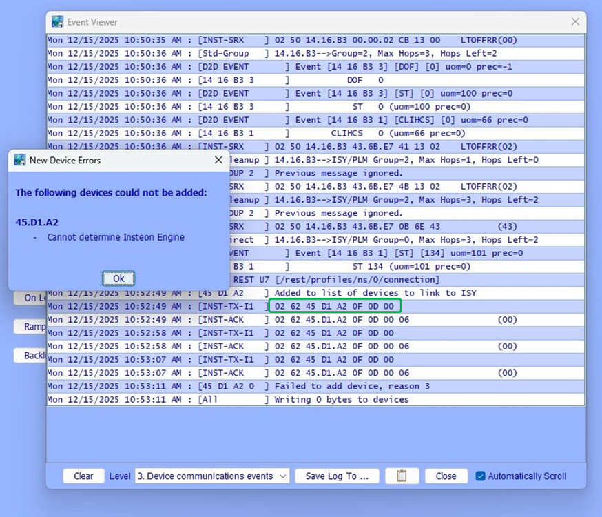

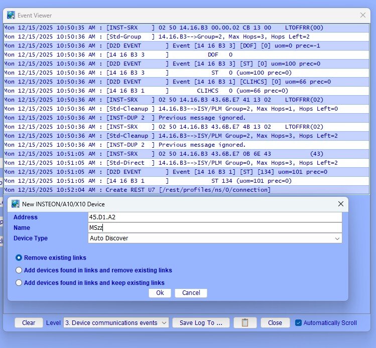

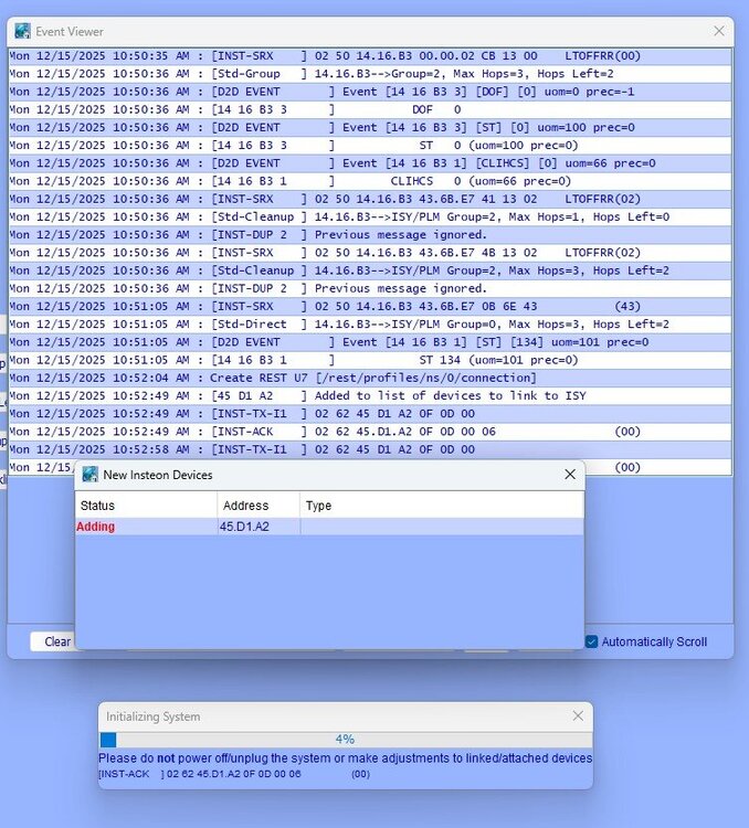

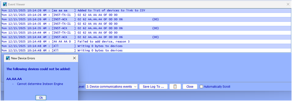

I cleared the event viewer and used auto discover as you suggested
It looked like it would add the MSII
Then it quickly timed out...
My MSII is sitting on my desk 15" from my PLM
@PapaBear , the ISY is trying to contact the MSII. It retries 3x and then times out.

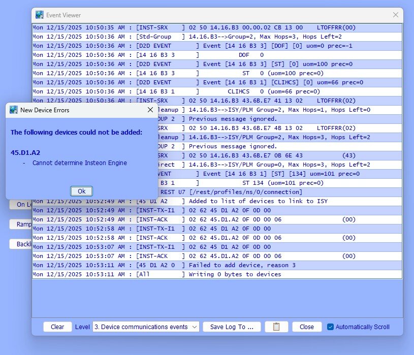

Did you happen to try monitoring the Event Viewer while re-connecting power to the MSII? I'm assuming you had the sensor connected previously.
You also seem to be getting a lot of activity from the device @14.16.B3. I'm guessing it's a thermostat. That's both good and bad. The thermostat is communicating well with the Insteon network (do know the point of access). The bad may be the traffic it's throwing at the system.
You might still try re-locating to a separate room - this will force a different RF access point to the system.

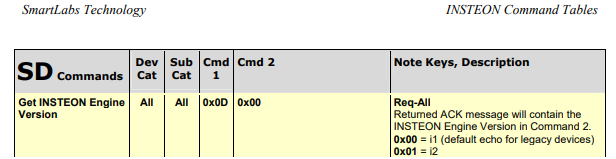

@oberkc , simply two different methods to link. Bottom line is the command shown below that is being executed by the ISY is correct (get Insteon Engine Version). If the MSII hears to command it should respond with an I2 engine version.
It is not responding which leaves us with the following options:
  1. Device address is incorrect. Possible, although I've never encountered a mis-printed label. There are methods where the device can be manually linked to determine it's address.
  2. The device can't hear the PLM because of interference in the area (or PLM can't hear the MSII). Move to a different location and re-try.
  3. Faulty MSII (it happens)

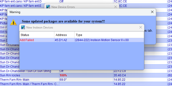

Thanks for all the advice. I tried the technique oberkc recommended (hadn't done it that way before). It didn't work either. Also, this is a brand new MSII right out of the box.
Also dleted java cache.
Now when i launch IoX I get these windows:
@PapaBear , the fact that this is a new sensor is relevant. It's possible that it's mislabeled or just defective. One curious item is the device address - 45.D1.A2. I have 4 of the MSII's that are already several years old. They all start with the address 4A.xx.xx. Insteon device addresses don't normally decrease on newer units.

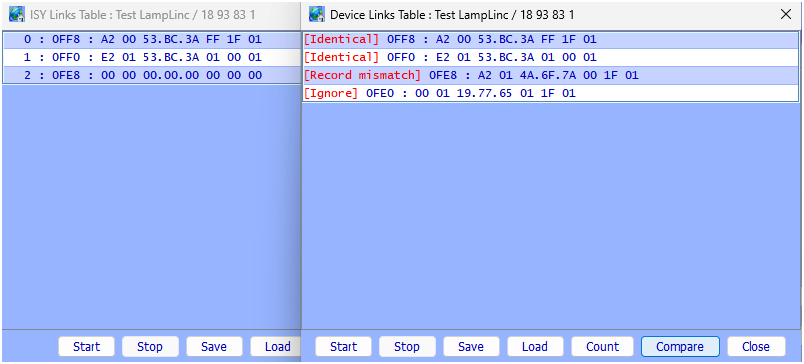

One last thing to try before we declare the unit "broken" - manual link to another Insteon device. This is just in case you have a misprinted address label on the MSII. I just did this with a LampLinc I had laying around -
  1. Place your MSII into link mode by holding the set button for xx seconds
  2. Place the device you with to link into link mode. Linking should be almost immediate.
  3. Assuming this works, you can find the MSII address in the link table of the device you just linked (use show device links + compare). In the example below the mismatched link is the manual link just added. The 4A.6F.7A is the address of my MSII.
  4. Remember to restore your test device to eliminate the manual link.
Edited by IndyMike
