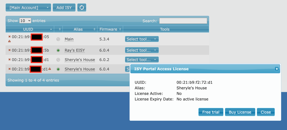

I never said that they did not have different MAC addresses - of course they were different. I was talking about the UIDs listed on the ISY Portal not the MAC addresses on the LAN.
I did say that on the ISY Portal - I had 2 entries for the same EISY. The ISY portal lists your device by it's MAC address (aka UID). There clearly was a duplicate UID on the ISY portal: one with OS 6.0.2 and the other with OS 6.0.4 With MAC addresses guaranteed to be unique this should not be possible to list the same device more than once. In my opinion, there should be no way to list the same EISY on the ISY Portal - but in this case it seems to be including the OS version as part of the "primary key" for that table.
The ISY portal is obviously not on my network so it has nothing to do with IP addresses or MAC addresses (which is the same thing as the UID). When I say ISY portal I am talking about the UD site where you can see your list of devices, pay for accounts, etc.
Yes, the fact that one was an R1 and the other R2 is not relevant, I never said it was. I was simply distinguishing which was which in describing the issue I was experiencing.
The device does not come out of the box with the free license, you have to go through some steps (THIS is the confusing part) - "and then" accept it. This is the part where having 2 devices on the same LAN seems to have become a problem. How does "eisy.local" resolve when you have more than one device? Probably the one with the lower IP address? I think this leads to the problem I was having.
The other part that is confusing is why does the admin console start up with 2 entries for the same device? One for "IoX" and the other "EISY" - both are the same device (same UID). Now, once you are in the IoX admin console and you go to the portal tab it will give you a link to go to - I believe that the URL it puts on the screen has "esiy.local" in it. Using the specific IP address would resolve that issue I think.
This is the screen from the ISY portal, Sheryle's House 6.0.4 was "thee" R2. It seems to me that the portal license is associated with the combination of UID AND OS version. Since UID is unique there should never be a duplicate of "Sheryle's House"
You can see that Sheryle's House 6.0.2 is offline AND Sheryle's House 6.0.4 does not have the ISY portal license (the little "!" icon)
If you are no longer using the unit that is off line, it can be removed by clicking the red x on the left side. If there is an active portal license associated with the device, be sure to address that first.
Ok thanks, that clears up a few things. As for the portal duplicates, I've been experimenting with a unit, setting it up over and over again as part of my tests, and when I upgraded it to 6.0.4 and accessed it for the first time, it asked me to log into the portal, where it added itself to my account. This is likely part of the new login scheme with the portal credentials, to keep things consistent. As @DennisC said, you can easily delete any extraneous entries by clicking on the "x". Release 6.0.2 was probably the initial release for the newer R2 version, and I don't think was ever released as an upgrade for the older eisy or Polisy versions. Seems we went straight from 6.0.0 to 6.0.3.
