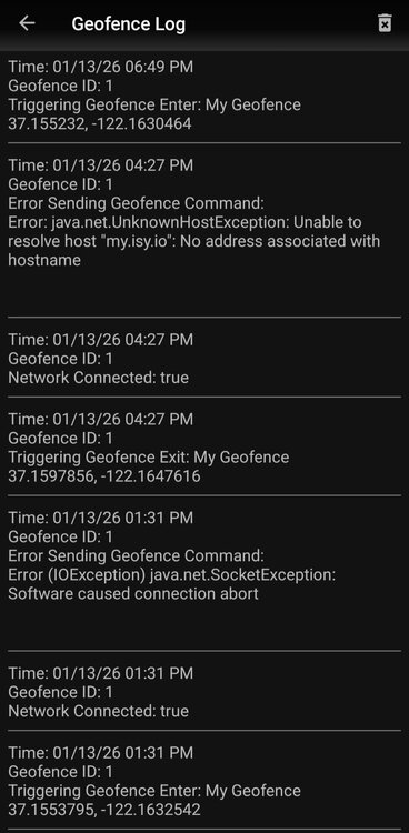

@Javi Hi again. I'm still getting GEO fence errors that cause it not to trigger 50% of the time, see image.

If issue persists please open a ticket with new logs. Looks like 2 errors. In one instance it could not reach my.isy.io possible DNS issue. The other is the connection was forcefully dropped while sending the command, possibly due to network switching or timeout waiting for DNS resolution.
