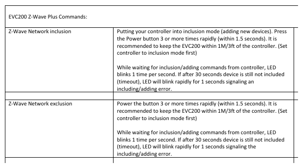

@raydoc , looks like you previously had an ISY994. That being the case, the EISY should be able to find your EVC200 ASSUMING it's in range.
Unfortunately the valve appears to be "z-wave plus" or z-wave 500 series. Not the best for range and very difficult if you don't have a robust mesh. Newer 700/800 series devices are greatly improved.
Since you obviously can't move your valve closer to the EISY, try moving the EISY close to the valve as shown in the users manual below. You should absolutely try excluding the valve 1st since previous excludes will not have worked with the EISY out of range.
