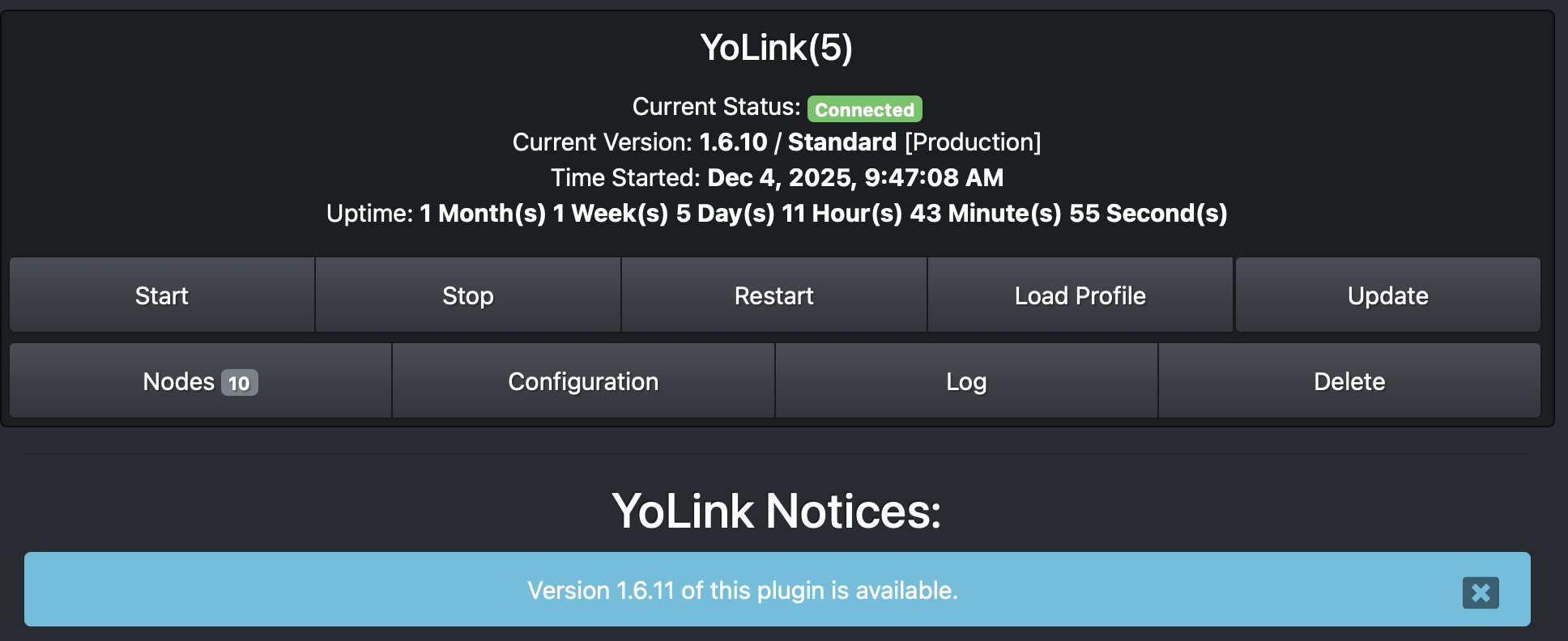

On my PG3 Dashboard, it shows an update available for the Yoink server.

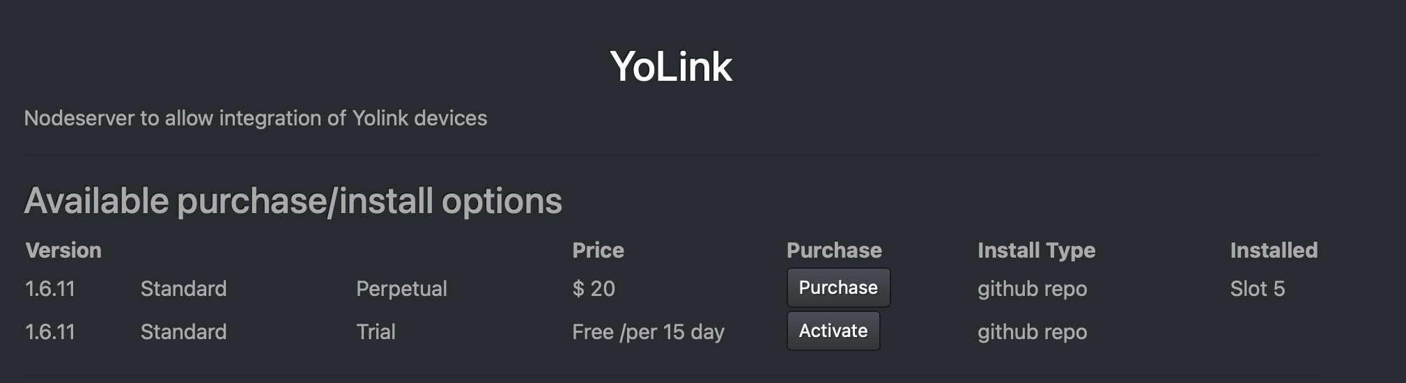

But when I click on Update, I get to this screen and no upgrade button. It's been while since I upgraded a plugin but I'm scratching my head right now. Any help would be appreciated. I bought this plugin back in 2024.
Thanks!
Go back to the main dashboard. Along the top menu there is an item that says Purchases. Is Yolink listed as a purchased plugin?

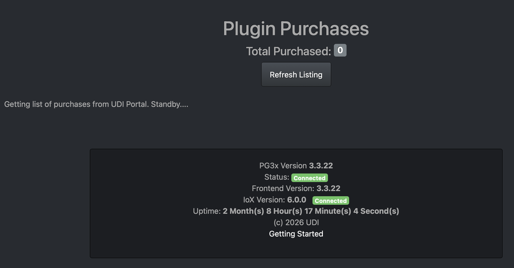

I have tried that menu item several times and it doesn't show any purchases at all. See screen shot. But my ISY Portal shows several plugin purchases. Not sure what is going on.
Thanks for the screenshot. I think the key to your issue is displayed in the screenshot. Notice it says "getting list of purchases"? To me, that means it is not getting the list and therefore, pg3 doesn't know you have purchased the plugin.
There is a shortly of things I would try and if they don't work, I suggest you stop and open a support ticket with UD.
  1. Try rebooting, wait about 15 - 20 minutes and try again. Make sure when you log in you use your portal credentials.
  2. How are you accessing pg3? Right now, if you are on eisy, the official way to access pg3 is from https://eisy.local or http://eisy.local.
  3. Log in to the portal and double check your portal subscription is active and eisy is online.
  4. Try running upgrade packages, be sure to wait for the notice to reboot and give ample time before logging in again.

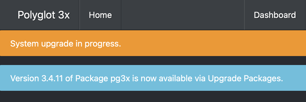

@DennisC thanks. So let's talk about #2 first. I was getting to my PG3 page through the Admin console. I did reboot my EISY and then the purchases showed up again and I was able to update the Yolink plugin. Thanks for that. I also found there was a package update to I'm installing that now. I did get a "Socket timeout" popup but it looks like it's upgrading. We'll see. Hope that message goes away when it's done. Screenshot 2026-01-16 at 8.59.15 AM.png

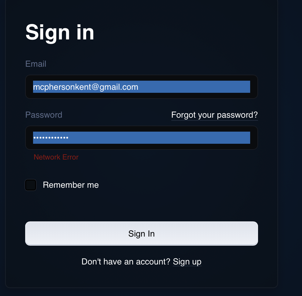

So http://eisy.local:3000/ does not work. My login credentials fail even though I know they're correct. What does work is going to IoX Launcher and picking my EISY name. From there I pick Polyglot V3 (PG3) from the drop down menu and that works. If I use the official way to sign in @DennisC shared about, it takes me to page titled 'eisy-ui' but the login fails with a network error. Getting a little more than confused. But I do have a way to access my PG3 dashboard in the meantime.
Does http://eisy.local work?
As I posted above, when you use port 3000 (which is no longer recommended) you are using a local port. That means your login credentials are your local credentials, not your portal credentials.
If you are using https://eisy.local or http//:eisy.local, sign in with your portal credentials. If you receive a network error, then I suggest going to https://my.isy.io/index.htm and try to login with your portal credentials.
If that still doesn't work, or you can login to the portal but not eisy UI with the same credentials using either of the two addresses I posted, then open a support ticket. Note: you could try a reboot first.
