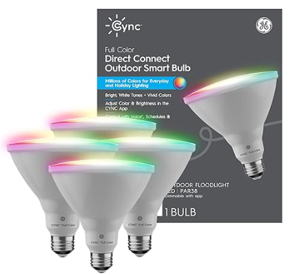

February 20Feb 20 16 hours ago, Guy Lavoie said:The GE Cync bulbs you indicated in your link might not be Matter devices. I warned about that in a previous post. I guess GE likes to group all their smart products under the Cync label. It's showing as a wifi bulb, controllable from their app. Yet one of the pictures mention Matter, but it's not mentioned on the box.I saw the picture that mentioned Matter and thought those bulbs were safe. Darn your unclarity, GE!!! 🙄Hopefully it's not out-of-bounds for this forum to just come right out ask: do you have a suggestion for a product/approach to accomplish what I'm trying to do?What I have: an eisy, the ZWave/Zigbee (but apparently not Matter!) dongle, and a 4th generation Alexa Echo Dot.What I'm trying to do: replace my outdoor spotlights with something that has individual programmable color control. I'm not planning to do a show, so they don't have to flash to music or be particularly quick to respond to color change commands.Thank you in advance for any suggestions you have!!!!
February 20Feb 20 Author For that particular bulb, I'd ask GE. There must be a support link somewhere. Their ambiguous product description needs clarification. Otherwise, Matter products are still few and far in between. At least we know that some GE Cync products support Matter, so start there first. If you do inquire, let us know what they say.As for what you have, well Matter is IPv6, and uses your network connection for communications. As long as your router supports IPv6, you're all set. If you get a Matter Thread device, then you'd need a border router. Your Alexa Echo Dot is not a border router, it has to be a Echo (not dot), 4th generation. This is the larger ball, about 6 inches in diameter instead of 4. Some other Echo devices also have it, as well as other makes. Here is a list. Maybe you already have one of these devices:Matter AlphaA complete list of Thread Border Routers on the market todayAlthough Thread doesn't need a "hub" in the traditional sense, you will still need another piece of hardware called a Thread Border Router—to take advantage of its benefits. So, if you are just startiAs for what you're trying to do, Philips Hue will also do that. The Hue plugin for the eisy is very comprehensive. Hue is expensive, but works well. But start by asking GE about that light first.
February 20Feb 20 Author In poking around, I found this:https://cyncsupport.gelighting.com/s/article/Cync-Products-with-Matter-Compatibility?language=en_USI don't see that bulb listed.
February 20Feb 20 Per @Guy Lavoie 's suggestion, I reached out to GE Support and received the following response in regards to whether or not the GE Cync par38 Outdoor bulbs are Matter enabled:Hey Eric, Thank you for contacting Cync Support. There is a specific Matter enabled version of the Cync par38 Outdoor floodlight available at the moment at Best Buy or Amazon. You'll notice the box is different for the Matter enabled model and will clearly state it is Matter compatible on the package. Here is a link to the Amazon. https://www.amazon.com/GE-Changing-Outdoor-Floodlight-Google/dp/B0G75MH42N/ref=sr_1_4?crid=1Q0KWYRKRCVHP&dib=eyJ2IjoiMSJ9.gcLZ4pZxOjnXJwSVyDmO_5oEuw_VYR0xSXf5C4YIQ_YET_FNF22woExDHmUAODhtwW3vv-Qm_iMO_YZd8d747YAX3bEufPgsEiSfasAVGTA9k8lOVQK0cE42q0RKKWwqvxUggVORf-aqEu30aGYVHpUNgbscwhS-ALpfDkkVVNElTGJ64FNgjmyFUSHb8xVkTiPYKplqanVR358bA9ep9cF-QTXocmNFj5xfJh-4HFdUF9RGnzezTh6ZZHigXYgRDKQCr0_Pc6lEfscPGn4MsCq2MhRc0WCUFg0AdQVyi2I.DQ0IN1Iir_8yLEIMpWazBVRul27d-vTejkS1QahrsfU&dib_tag=se&keywords=Cync%2Bpar38%2Bfloodlight&qid=1771617545&sprefix=cync%2Bpar38%2Bfloodligh%2Caps%2C112&sr=8-4&th=1Sincerely,Jeffrey CTechnicianGE Lighting Smart Support Teamcyncsmart.com
February 20Feb 20 Author Hah, this keeps getting more interesting! So their "Matter compatible " list is also not up to date.Make sure that's the version you actually get!

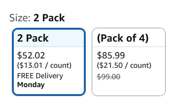

February 20Feb 20 I'm pretty sure it gets BETTER!!! If you follow the Amazon link, it takes you to a 2-pack of Matter enabled bulbs. There is a handy selector to choose a "Pack of 4" instead:HOWEVER, clicking the larger size causes the image to change to a 4-pack in a gray box ... the same gray box that doesn't mention Matter:So, if the pictures are accurate (which I am learning is not always the case), the 2-pack is Matter enabled while the 4-pack is not! 🤦♂️
February 21Feb 21 Author Given that the only difference is software, they're probably updating their product line over time. If you order the Amazon ones, make sure you're not getting older stock. And keep us up to date on how it goes.
February 21Feb 21 Did you also notice that the price/unit is wrong for the two-pack? I've noticed that, over time, there are a lot more negative reviews on product pages where the issue is old/wrong version and/or used/repackaged product - to the point where I don't buy some types of electronics from them anymore. I use B&H Photo instead (no affiliation, just a happy customer).-Tom
February 21Feb 21 Author I didn't notice the price per unit discrepancy, But I've seen many reviews about people getting repackaged products. There are also often errors in technical specs. I was just looking at some motion detectors for alarm systems and they often specify that batteries are needed when not, or even the wrong quantity of batteries for some other products. Not very credible.
