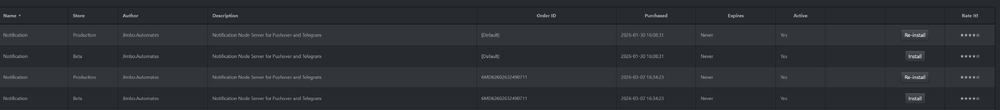

  1. I think I might have purchased twice - see screenshot? I'm not understanding why so many entires.

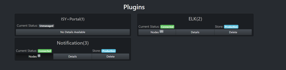

  2. I followed the setup steps but seeing this in my dashboard and still not getting anything to configure alerts in the java admin console. I entered portal key, app key, etc. Any ideas?

If you click on the "Details" button of the plugin you should then have a configuration option. Since both the Elk and Notification show to have nodes currently something has been setup.
UD said 4 entries on the "purchased" apps was standard and fine.... OK.

If you are referring to the number after the plugin name, i.e. ELK(2), that's the slot that the plugin is installed in.
sorry I'm not being clear, I have notifications installed on slot 3. When I click details there are 4 "nodes" ( I don't know why).
I've attached a screen shot of the nodes.
On the config page, I've set the 'acknowledge', rest_port, and portal_api_key.
I've also set the pushover service nodes based on keys from pushover.
I've also set ISY service notes using same portal_api_key as above.
I've rebooted everything a few times. Shouldn't a see a GUI in the client admin console to configure notifications? I don't.
