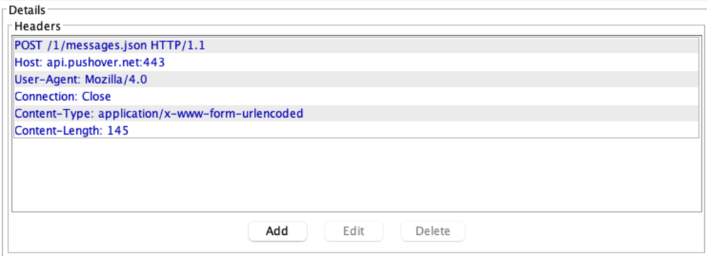

Config in Network Resources:
POST /1/messages.json HTTP/1.1
Host: api.pushover.net:443
User-Agent: Mozilla/4.0
Connection: Close
Content-Type: application/x-www-form-urlencoded
Content-Length: 145
token=XXXX(replaced from actual)&user=XXXX(replaced from actual)&priority=1&sound=persistent&device=Stan_iphone&message=Home Fire Alert!!

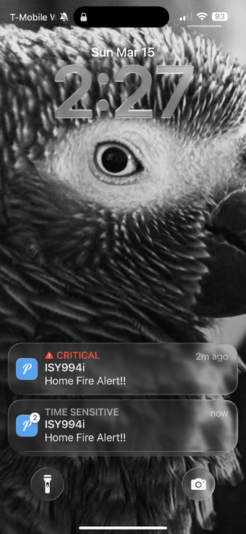

Although I don't get an error when including those changes now I lose the sound and the alert changes to time sensitive losing the red exclamation. Here is a screenshot of my home screen showing both the priority 1 in red and the priority 2 that looks plain.
I'm not as concerned as the exclamation but no alert tone bypass would be an issue.
I did try changing orders like putting the sound right after priority and after the retry/expire and didn't seem to change that.

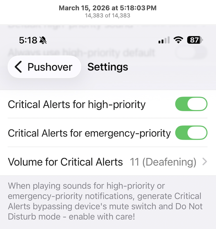

Hi Paul,
You nailed it again. In the Pushover app there is a setting for enabling the Critical Alerts for Emergency which apparently are #2. I enabled this and have the red alert now and the sound comes through. Honestly, never knew the volume was adjustable on Critical alerts.
If this doesn't get my attention, my wife's or anyone around us on the deafening setting if there is a smoke or CO alert nothing will.
So in summary.. you need to add the "retry" & "expiry" settings as well as ensure the Pushover app is enabled for Emergency Alerts.
I changed the 60 seconds to 30. That seemed like the minimum. I tried 20 and under and it failed. I do see these settings on the Pushover site and not sure how I missed it before.
Thanks for your guidance and all you do here as always! You could have saved a life or my pets (2 birds & 2 dogs) in the future.
