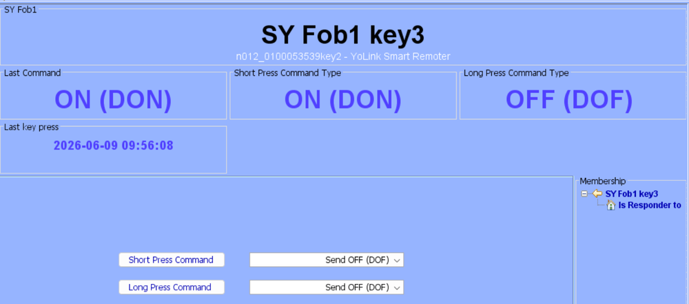

You can specify what even/control a short press, and long press sends for each button in the button sub node. E.g. Short press send DON and Long press sends DFOF fast off) - there are 4 options to select for each button or an option to toggle DON/DOF of DFON/DFOF for each press. You can then control on those events - note if you have the on/off remote you cannot only specify an event for the push (as it does not determine long or short press)
e.g. program for long press on key 3
s FOB1 Key3Long - [ID 0093][Parent 000E]

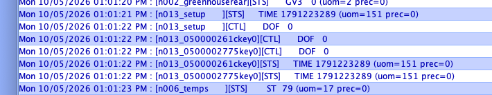

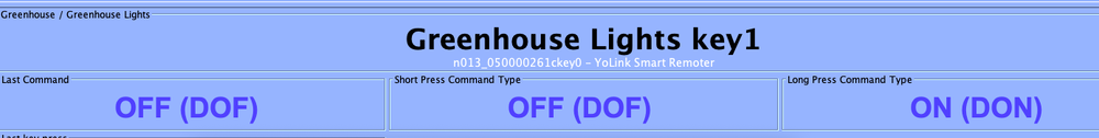

I am having a similar issue with my "YoLink Smart Wall Light Switch, Single Pole, 10A, YS5708" - there are two child buttons on this that I am using to control sprinklers. I am triggering short press = DOF, and I have two programs. If the Rachio is running and button is pressed, it shuts them off. If it's not running, and button is pressed, it runs them for X minutes. Issue is its ghosting random presses afterwards and either stopping or restarting them over and over. Any help would be appreciated- I am on the 1.8.60 release. But I noticed this was for a different device - not sure if your fix covers mine. To be clear, these button presses have timestamps when no one was near the switch. Thanks - let me know if there is anything additional you need from me. Here is what that node looks like: image.png
Also, here are a couple of the ghost presses:image.png
