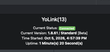

I'll build a version 1.8.61 in the non-production store to make sure it works for you - can you test before I release
Perfect. I was just about to post that I am 99% sure I just got a phantom press - I was chasing down two issues, one with the Rachio and the other with the Yolink button - so when I saw the Rachio issue, I thought it was making me think this was an issue - but I figured out a programmatic way of getting around the Rachio problem, and then the button just pressed like 20 minutes after the last time I was using it. So this makes me feel alot better. Will be happy to test. I haven't installed a "non production" store plugin before. Is it pretty obvious where to get this?
And I found the non production drop down, ready where you are. Thanks.
So far, so good. Just uploaded it, and ran it, no phantoms yet. Let me wait about an hour to ensure we are good.
