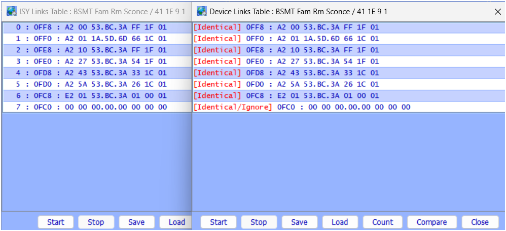

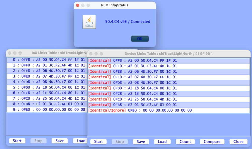

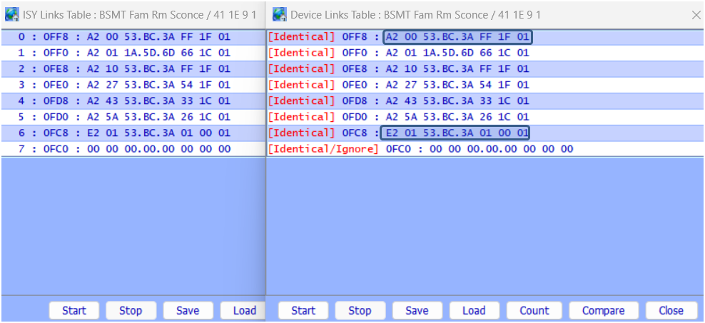

July 25Jul 25 @Bumbershoot , your Switchlink is missing the Link that tells it to be a controller to the PLM. From my SWL table below, the E2 entry @0FC8 tells the unit that it is a controller of the device @53.BC.3A (my PLM).Your device doesn't have this link. Without it, the SWL will not communicate to the PLM when it is activated.Unfortunately, the ISY believes the table is correct. That means the ISY data is also corrupt. You could delete/re-add this device but you seem to have quite a number of scenes that it is involved with - that sound painful. You also mentioned that your PLM seemed to have surprisingly few Links - could you quantify that (number of links vs number of installed devices)?Given the above, I'm leaning toward asking you to install from a previous backup (Restore ISY).
