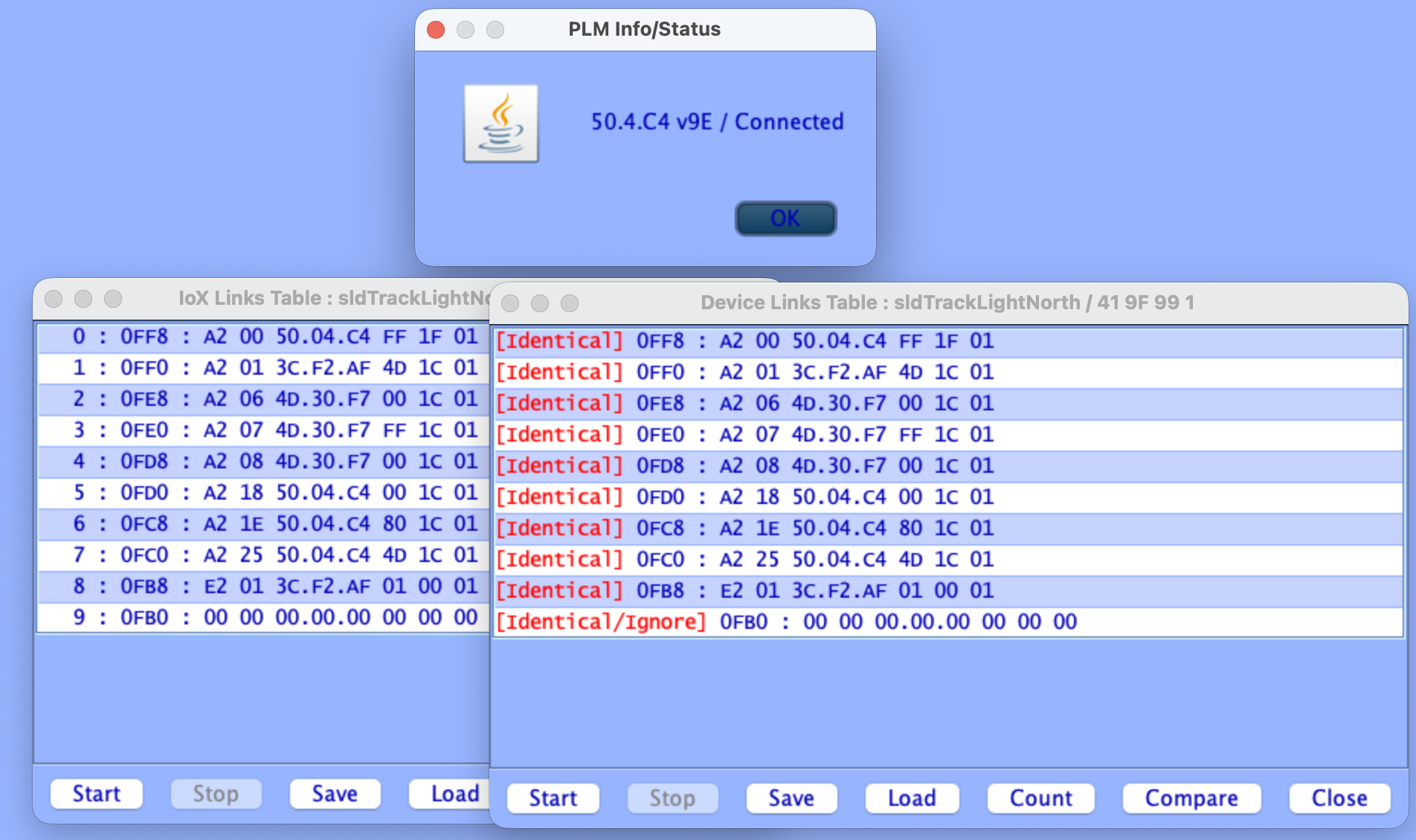

  12. No change in behavior after performing the PLM restore procedure to the letter. It looks like the switch sees the new PLM, and I can control it from the AC. I don't understand why the program doesn't work at all. In the screenshot below, the links are the same from both the ISY and switchlink dimmer, and the dimmer appears to see the new PLM.

  15. Background: I had to replace a PLM recently, and I've had to rebuild several scenes, and 'scnCooking was one of them. The two switchlink dimmers in the "If" stanza of this program are also in a scene that creates a three way for the track lights. I've restored these devices, factory reset them, updated the scenes several times and updated this program several times. For reasons I'm not understanding, this program will not work, as the "Fast Off" for either of these switchlink devices is not captured by the ISY software. I can run the "Then" stanza from the AC and the "scnCooking" is turned off correctly. A fast off does indeed turn off the track lights appropriately, but the program doesn't run. The status of the switchlinks will not update in the AC unless a query is run, then the status is updates. I'm a bit baffled by this. I'd appreciate any insights here. Thanks! CookingFastOff - [ID 0008][Parent 000A] If 'Devices / dirKitchen / sldTrackLightNorth' is switched Fast Off Or 'Devices / dirKitchen / sldTrackLightSouth' is switched Fast Off Then Set 'Scenes / scnCooking' Off Else - No Actions - (To add one, press 'Action')
