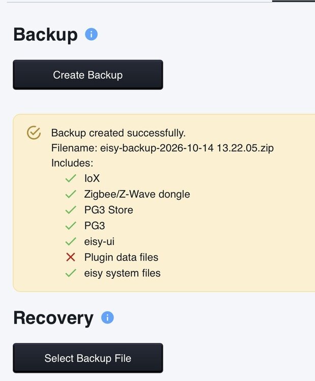

Wednesday at 06:50 PM3 days Several questions arise:1) is it time / helpful to migrate over? 2) are there updates to the Beta version of the plugins feature or a time frame as to expected progress? 3) is they why when I do a backup from the UI it shows this error for the backup?
Wednesday at 07:06 PM3 days Yes, the X is simply telling you there was nothing to back up in that area.
