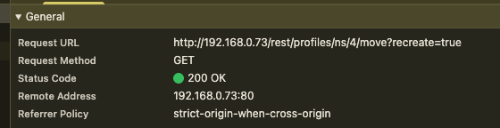

All of the /api/profile requests return a 401 error. Am I calling it correctly:curl http://192.168.92.14/rest/profiles/ns/23/move?recreate=true
i upgraded to the latest packages in staging and rebooted. That didn't help, still save issue.
Very strange, the endpoint looks correct, I copied into chrome exactly. Even without an NS in 23 it succeeds, also returned when changed to an NS that does exist. 401 is usually invalid creds so maybe try in a browser? Legacy "/rest/" can work on Port :8080 with local creds, eisy-ui APIs "/api/" require portal creds, and do not work on port :8080 (80 or 443 only)
However, If issue persists after reboot, I'm not sure that is the cause. eisy-ui's server should not have a cache and all request again. To be safe it would be ideal to resolve the 401 first. If this does not resolve it may point us to the issue.
If it does resolve and does not fix the issue, we will need to check for race or missing invalidation by forcing the server profiles to reload. Currently the only way to do this is by event _3 control NI or ND, translates to Node Added or NodeDefUpdated. So, try installing another node server into another slot, which will add a node an force invalidation. We know the Node Added works 100% of the time, but very possible race in Node Def Updated, this is not something easy to see in the UI, like a node appearing.
