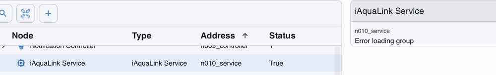

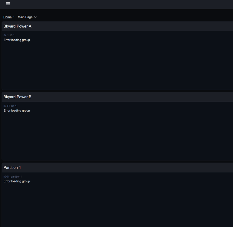

Question, after every update I'm left with an error loading group and a reboot doesn't fix. Pulling the power is always required.
Is this expected behaviour?

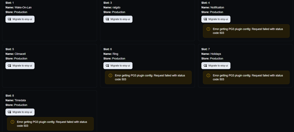

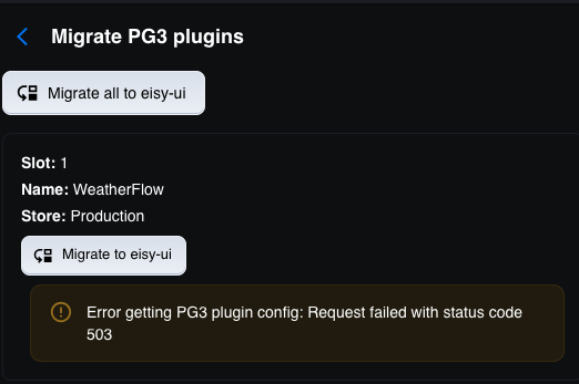

Migrated this morning. All seems good except I cannot migrate PG3 plug-ins. I've tried 4 and I get the same message on each "Error getting PG3 plugin config: Request failed with status code 503". Am I doing someting wrong?
Edited by Mr B
Update: Opening a ticket
23 minutes ago, mmb said:
Thanks @bmercier , up dated and everything seems fine
Thanks for the tip, @mmb I had to unplug as well to get the plugins operational.
My brother has an almost identical setup as me except a much smaller set of devices. I do his Eisyui updates and see the same behavior on his.
Note: Plugins are unresponsive after the update and subsequent reboot from the Eisy. I checked services and IOX was not running, so started it. That didn't help so restarted the eisyui service, still nothing. Power reboot fixed everything.
Also note, my brother ran into a recent issue that couldn't be fixed so reflash was necessary. So the Eisy should be pretty close to factory except one update. He's a little gun shy about updating to these latest updates.

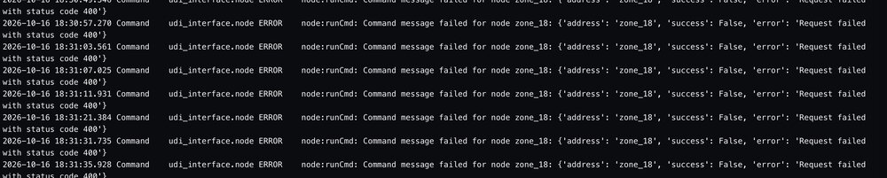

Elk plug in is only finding Outputs...
See sample screenshot of log.
Any advice to fix? I have restarted it twice. Will reboot eisy to see if that fixes it.
