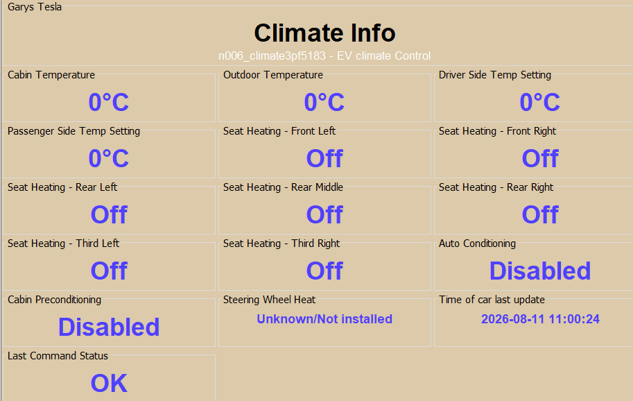

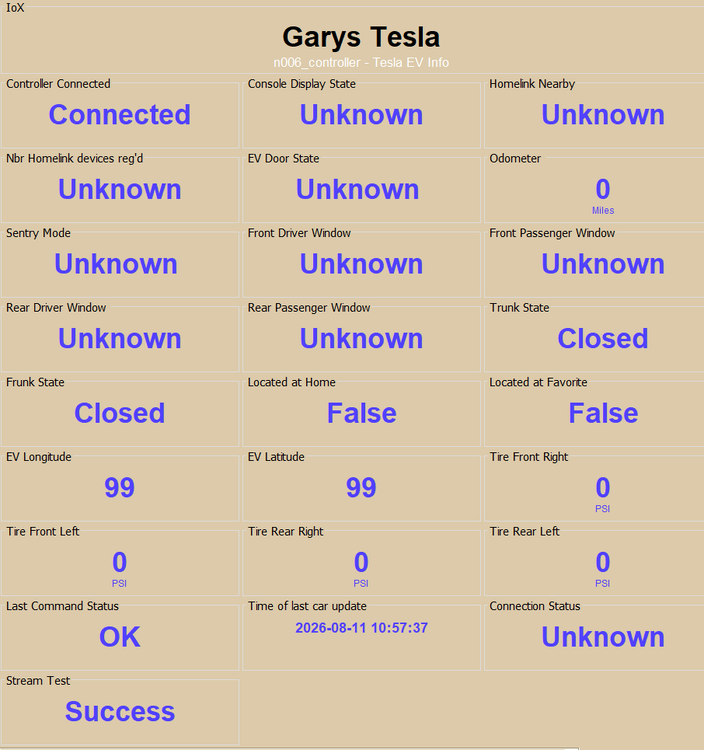

August 11Aug 11 Author I gave it a try but still no data. I did a restart and authenticated again but no change. The Tesla was awake. At first I though that the NS was interfering with the app because commands were timing out but later it seemed to clear. I included a few screen shots.
