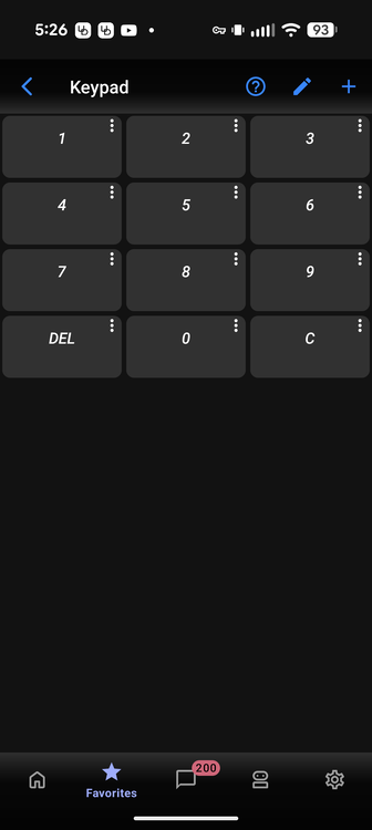

3 hours ago3 hr While having a tablet unlocked would allow a user eventual access, you could make it difficult.Create your keypad.Map numbers to variables/programs. E.g have a var for key entered and a var for keys entered (requires some math). Then a program to do math and update keys entered var. Another program which does alarm functions when keys matches.Hide the alarm nodes, keypad programs and keypad vars in UDM.
2 hours ago2 hr Author That's along the lines of what I was describing earlier. Map each of those buttons to a program which dynamically builds the PIN. So the keypress would add a number according to its keypress value which would be added to the dynamically built pin multiplying its previous value by 10 each time before adding the new keypress. At whatever length is needed for the PIN it would either kick you out with an error message or run the program.This would work for running programs, setting device status, etc but it would not work (AFAIK) to allow you through to an entire page of password protected features. eg - my house has six Elk areas - All the arm/disarm programs are on one page so it would be great to just password protect that page (folder) in UDM. The same can be said for having multiple Schlage/Yale/etc locks on one page that could be locked/unlocked from one place or any other sensitive data.I agree that the implementation you describe is do-able and not particularly complicated but it seems like something that is so totally reuse-able and practical for such a wide variety of purposes that it makes sense for it to be a built-in function. It's just 2 more properties for a folder. Whether it's password protected and if so what the password is. When a user hits the button for a folder it could check if the folder is password protected and if so pop a dialog asking for the password. Edited 46 minutes ago46 min by MarkJames
