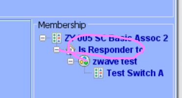

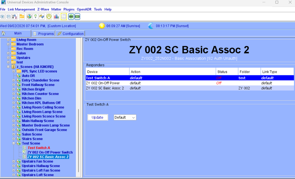

But I cannot get scenes to work with zwave as a controller to turn on/off insteon. I can add zwave zen71 switch to a scene like I have done in the past using its basic assoc 2 node... but it never controls the Insteon device. I have check all parameters on the zwave swtich - nothing works. I even factory reset ZMatter.
IoX is supposed to do some magic behind the scenes to make ZWave devices act as controllers - picking up the on/off presses from the zwave switch and mapping as a controller to a scene but it appears that it no longer works.
Some evidence here possibly in this thread below....
Did this get broken in an update? I am on a Polisy 6.1.2
Not a huge deal since I can use programs but this is kinda driving me crazy LOL.

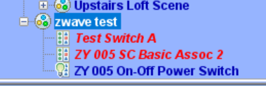

Interesting that I have to put a 1 sec delay or else the switch turn on/off.. maybe because I am turning on the scene instead of the device and direct device turning on/off does not have this issue...
Note I renamed the scene after the top screenshot from test scene to zwave test.
ZWave Switch Scene Controller - [ID 0009][Parent 0003][Enabled]
If
'ZY 005 On-Off Power Switch' Status is On
Then
// Needs a delay to prevent race condition
Wait 1 second
Set 'zwave test' On
Else
Wait 1 second
Set 'zwave test' Off
