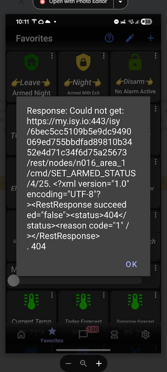

This is the same issue I see, this is arming my Elk panel. It succeeded in arming, but I got the message. It is a command type of favorite that sets the alarm system to armed night in this instance. Arming the system also triggers some programs in IoX to run.
Probably the same issue, if multiple commands is issued to the same node server in a very short period (usually less than a second) the error is shown. I think this is due to a timeout, but not exactly sure. This has always existed so is not a new issue.
If this happens in eisy-ui plugins (not PG3) we can investigate further, no point in fixing something that is already being replaced.

It i just one command, "set armed status night".
Filter the PG3 log for /cmd/, if there are multiple in the same second it is the same issue.
