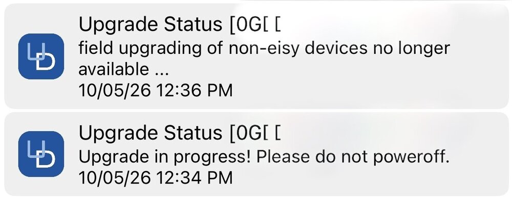

Just attempted to update my Polisy Pro from v.6.0.5. Within 2 minutes of starting the upgrade, I received the following message in UD Mobile:
Am I not able to update?
Solved by FloridaGary
Yes, but you'll need to do it manually, using ssh to access it. Once in:
sudo repo.util
sudo pkg upgrade isy udx eisyui pg3x
Once that finishes:
sudo reboot
