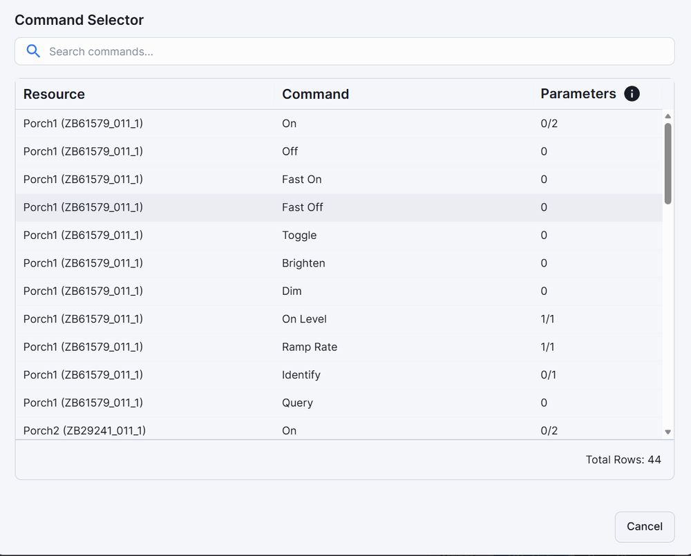

If you go in eisy-ui and bring up the scene, you'll see the controller at the top and the list of responders below it. Now click on the ">" beside (on the left) of the controller and the responders expand to a list of editable boxes. Click on the light you want to configure, and change the Link Type from "Default" to "Command", and a Command box will appear. Pick the setting you want to edit, such as "Set RGB Color", and then you'll be able to set the value to what you want for each parameter. You can really edit everything.

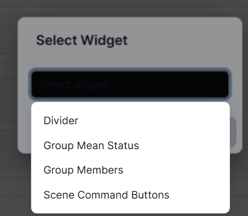

1.) adding all 4 bulbs to a Group > which creates it own Node > then adding that Home Page. when I try to add a widget, I only get (Divider, Group Mean Status, Group Members, and scene command Buttons) See below

The issue is status, scenes do not have a status, a widget requires both a command and status, the status is used to set the current position of the slider. Scenes allow command can be set to all members, but combining status for all members presents issues. While this seems easy, what happens when on bulb is off and one is on, the mean is 50% but neither light is at 50%. So it is easy to set multiple devices to a value, difficult to make a slider or other widget.
In UDM we use this mean status, and this is frequently debated and incorrect. At some point we may implement the same as UDM, but is likley months out at this point.

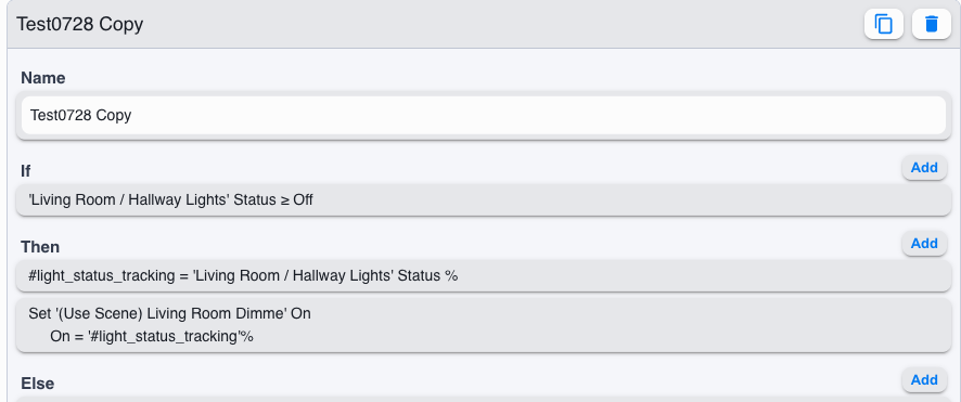

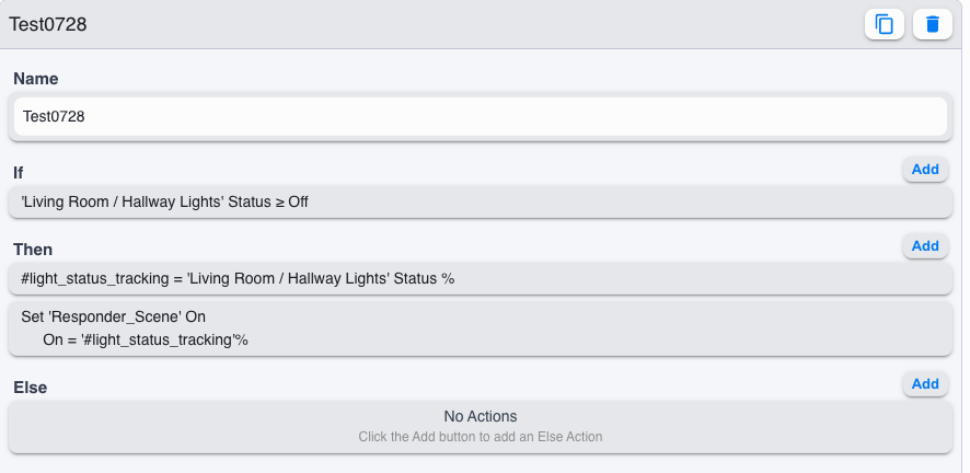

Choose one device as the controller then track its status and set a variable.

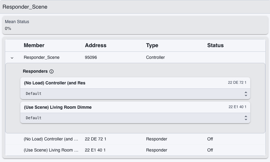

Then either create a scene with the other devices as "default" and set the scene to the variable OR set each device to the variable. Note my device is named '(Use Scene) Living Room Dimme' ..not a great name for this example.
Default (Do not use native as ON percentage commands do not pass through native):
Screenshot 2026-10-16 at 4.26.33 PM.png Screenshot 2026-10-16 at 4.26.05 PM.png
OR Each Device:
Now control the device selected as the controller, the program will update the others
