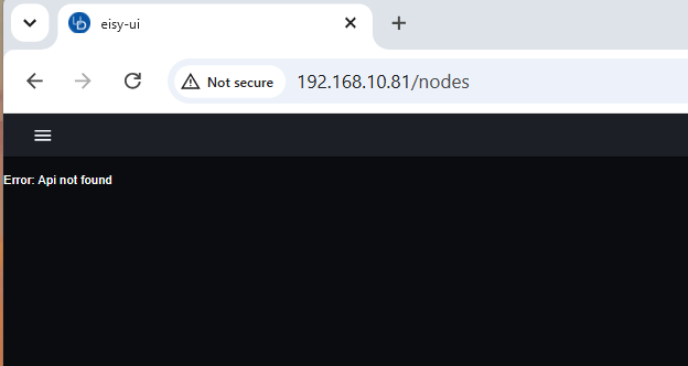

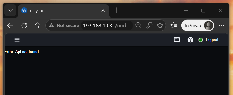

Checking out the new Network Resources page in UI. When I click on one, I get details about the Network Resource but not the actual content.
Am I missing something?

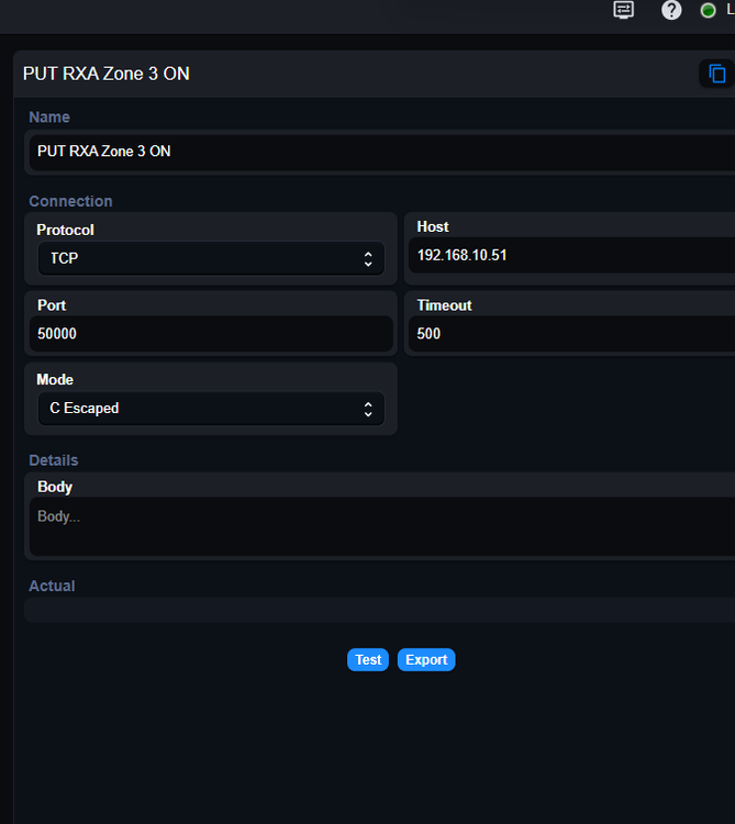

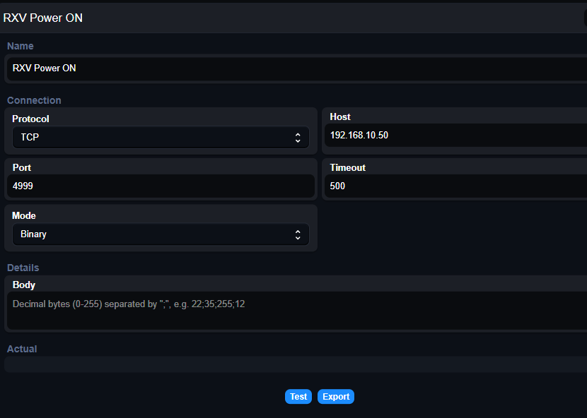

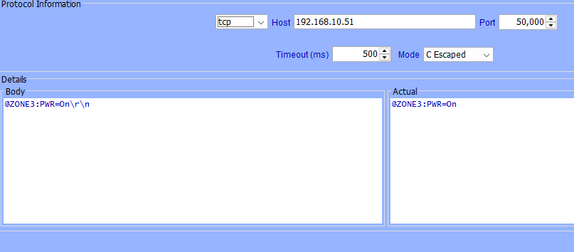

Screenshots comparing AC with UI for the same command:
All firmware and software fully up to date.
The invalid characters are likely because they are represented by the "2" and "3", however they are required per the Yamaha serial protocol used by my (much) older Yamaha receiver.
I also have a newer Yamaha receiver using POST. They too, do not display in UI. (Screenshots).
FWIW, all commands function properly in EISY and UD Mobile. I can also execute them successfully with the "test" button in AC.

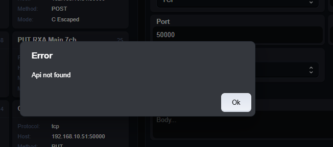

Seems neither Test nor Export work in UI, resulting in an "API not found" error.
