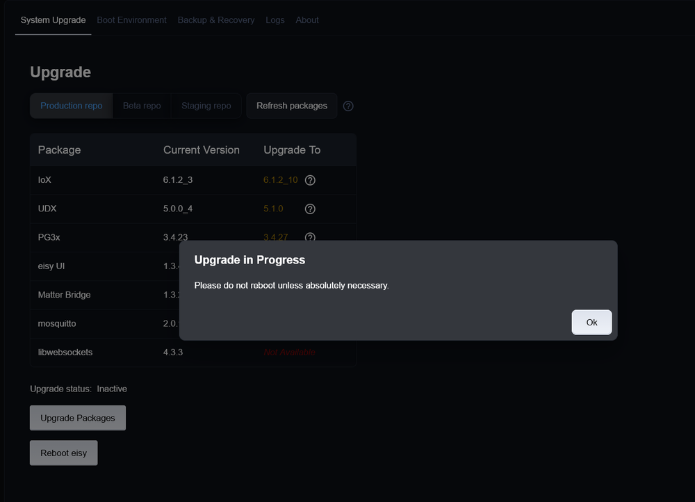

October 18Oct 18 Some weeks back and with help e.g. from this thread I was able to upgrade my Polisy. I have not run into any issues since.Now I see that there are new versions available. What is the process for updating to those? I have tried via the web interface a few times, including waiting for some 10 minutes in between and reboots. It still shows the old versions. Do I have to use SSH again? If so, what are the steps/commands.Any help would be greatly appreciated?
Thursday at 11:43 PM2 days you need to update with ssh everytime, the GUI will not update packages for polisy.I just did latestInstalled packages to be UPGRADED: eisyui: 1.3.4 -> 1.4.9 [udi] isy: 6.1.2_3 -> 6.1.2_14 [udi] pg3x: 3.4.23 -> 3.4.28 [udi] udx: 5.0.0_4 -> 5.2.0_1 [udi]Number of packages to be upgraded: 4Type in:sudo repo.util stagingthen:sudo pkg upgrade udx isy eisyui pg3xInstead of looking at blank shell, you can check status in ssh live after it does the intial part:tail -f /var/log/messagesAlso eisy-gui will show the upgrade in progress, please wait
Thursday at 11:49 PM2 days No, with the version you're now at, upgrades from the menu in eisy-ui should work. Not sure why it's not working for you. You could try the ssh method anyway, maybe you'll see why it's failing.
Friday at 01:36 AM1 day Author Thanks guys,I ultimately tried upgrading via ssh (sudo pkg upgrade udx isy eisyui pg3xsudo reboot )a while back and it eventually seems to have worked.I just now tried again via the gui Upgrade package button and to my surprise this time it appears to have worked that way too.
