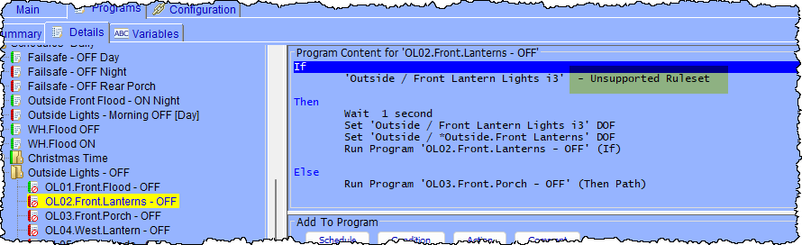

jAC Issue 1 - Programs with i3 in IF Statement Displays Unsupported Ruleset
I noticed that the jAC can no longer handle 11 of my 13 Insteon i3 devices. I first noticed this in the jAC while looking at a program that triggers on an i3 paddle switch device's status. It appeared as follows. Notice the Unsupported Ruleset in the IF statement. I was unable to edit the IF condition in the jAC. My best guess is that this is because the jAC cannot correctly read these i3 devices statuses.

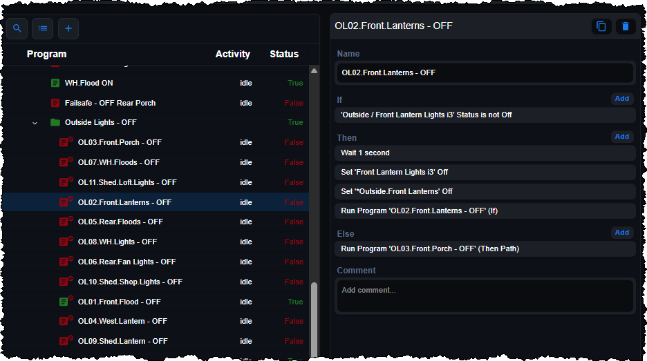

The same program containing the i3 device showed the IF condition correctly when veing in EISY-UI.

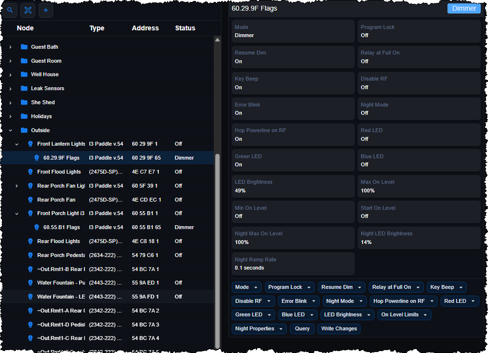

  • I discovered that the i3 devices have additional flags under the flags node. There are new flag items (Night Mode, Hop Powerline on RF, Night Max On Level, Night LED Brightness, Night Ramp Rate, etc.) I have never seen before.
-Emile
