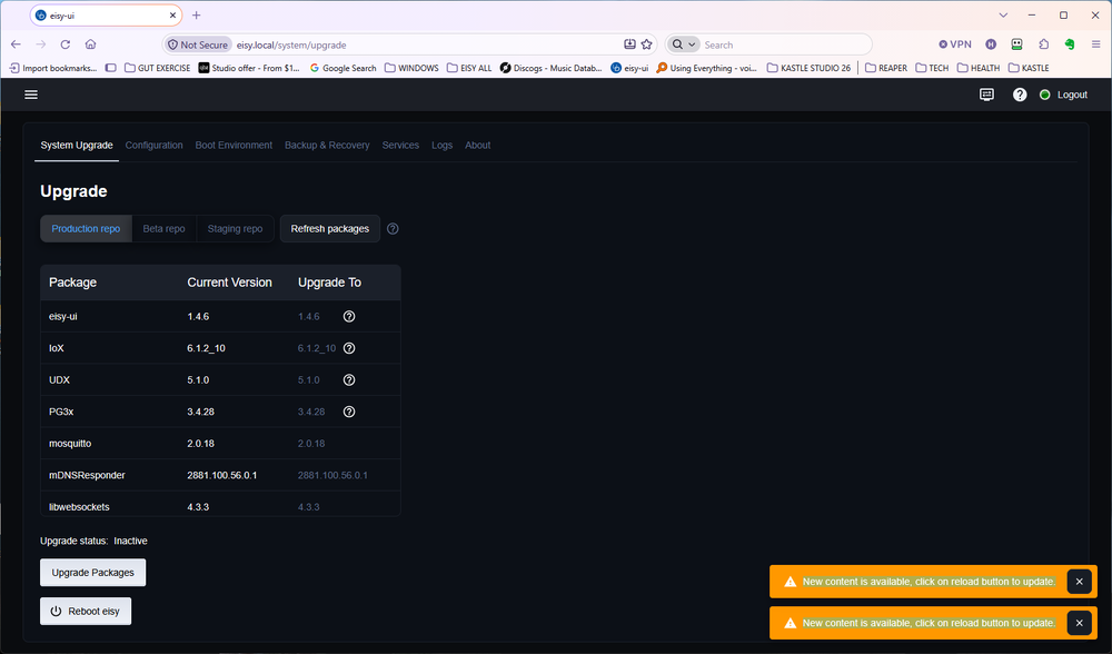

After having updated IoX to 6.1.2 eisy-ui is throwing a message saying "New content is available. click on reload button to update"
Assuming that's referring to the browser reload, regardless of Update Status: Inactive it's recurrent.
No new devices have been added.
Thoughts?
eisy-ui 1.4.6
IoX 6.1.2_10
UDX 5.1.0
PG3x 3.4.28
mosquitto 2.0.18
mDNSResponder 2881.100.56.0.1
libwebsockets 4.3.3
Try a hard refresh using Ctrl-Shift-R.
If that does not fix it, you need to remove the "Service worker". I'm not sure in this browser, but in Chrome that would be F12, Application tab, Service Workers - delete the service worked. Need to find the equivalent for this browser.

Clearing the cache always worked for me.
Thanks all for the speedy help!
