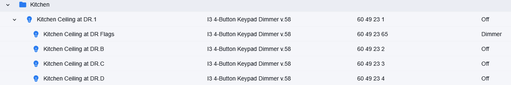

I have 10 i3 KPLs already in the eisy. They all correctly show 5 nodes, 4 buttons 1, B, C, D and 1 Flags. These where added before I started using Eisy UI. But!!!, I think I added one on the eisy ui before the latest update and it was correct.

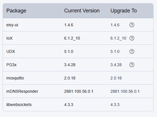

Current firmware:

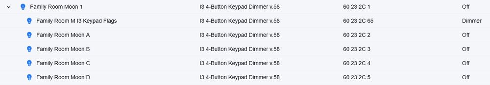

Tonight I added another i3 4-button KPL and it keeps coming in with 6 nodes: 1, A, B, C, D, Flags. Nodes 1 and A respond the same as seen in the ui. It should show 1, B, C, D and Flags. I have not yet made scenes (groups) from the recently added KPL as it is not right.
I have deleted it, rebooted the eisy via menu, factory reset the KPL, yet it didn't fix it. I also unplugged eisy and let it come back up, factory reset the device again, still didn't fix it. The newly added KPL keeps coming up with one too many nodes.
Wrong:
The other 10 already in my system are fine, 1, B, C, D, Flags.
Correct:
Too see if I have a bad kpl, I added another i3 4 Button KPL, but the result is the same, 1 too many nodes.

Not a bug, this is the new implementation. For i3 the load and the buttons can be detached or attached to any other button. so Load + Buttons + flags. delete and re-add the others to split the load out of A

It is not the same, the i3 the load (1) and Buttons are separate. The device itself has it's own "internal scene" which can link a button to the load. But this does not translate to an ISY scene. While this may have sort of worked when linked to button A, it completely broke when the load was set to another button. When creating an eisy scene both the load and the button must be included, even if they are linked in the "internal scene"
However there may be an issue with the version number. v0.56 appears to behave differently than v.0.58. Which version do you have?

I updated to eisy-ui version 1.4.8. Was 1.4.6 Production repo.
