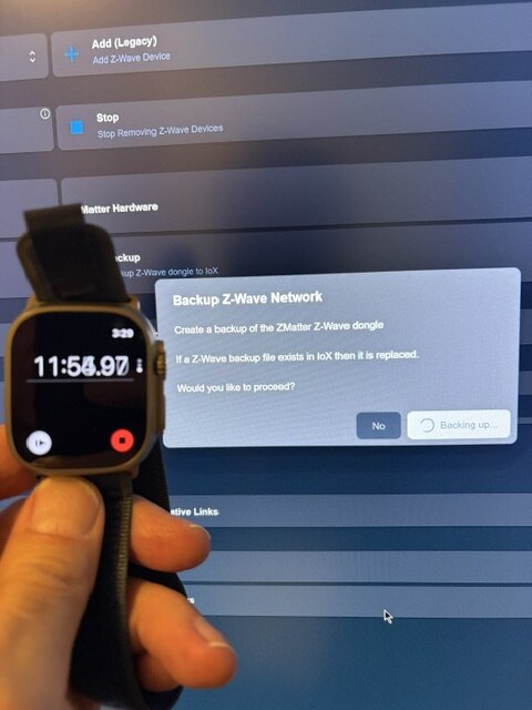

October 29Oct 29 @bmercier I tried the z-wave backup function, but it doesn't seem to ever finish. I presume it should complete in a matter of seconds - mine just spins and spins,I am using the UD z-wave dongle.However clicking anywhere on the display clears the Backup popup.It is reproducible, I have not tried a reboot at this point.

October 29Oct 29 Author 1 hour ago, bmercier said:It can take minutes.Also make sure to run version >= 1.4.8Thanks Eisy is up to date, 1.48.Tried it again, doesn't seem to finish and restore fails as well.Maybe I should reboot? Edited October 29Oct 29 by mmb
October 30Oct 30 2 hours ago, mmb said:Thanks Eisy is up to date, 1.48.Tried it again, doesn't seem to finish and restore fails as well.Maybe I should reboot?Likely the process is finishing, but for some reason the UI is not being updated.First reboot eisy, wait at least 5 minutes, so we start from a cleans state.Run the backup, if it does not finish in 30 secondds click out of the dialog. Download the Zwave LogDownload the Event Viewer Log, from the Event Viewer Tab (this is the UI's log, must be done before any refresh).Attache logs to a ticket for investigation
October 30Oct 30 Author 13 hours ago, Javi said:Likely the process is finishing, but for some reason the UI is not being updated.@Javi I checked the Z-wave log, it successfully finishes, but as you said it's just the UI isn't being updated.[2026-10-30 07:42:29.687] [I] [iox] ZWAVE-WORKQ-35 Queue backup ZMatter Z-Wave dongle[2026-10-30 07:42:29.687] [I] [iox] ZWAVE-WORKQ-35 Start backup ZMatter Z-Wave dongle[2026-10-30 07:42:29.687] [I] [zddx_operations] Saving configuration one file data[2026-10-30 07:42:29.701] [I] [iox] ...backupZWayDongle - Reboot dongle[2026-10-30 07:42:29.701] [I] [...] Adding job: Soft reset[2026-10-30 07:42:29.707] [I] [iox] ZWAVE-WORKQ-35 Finished backup ZMatter Z-Wave dongleDo you still want a ticket?
