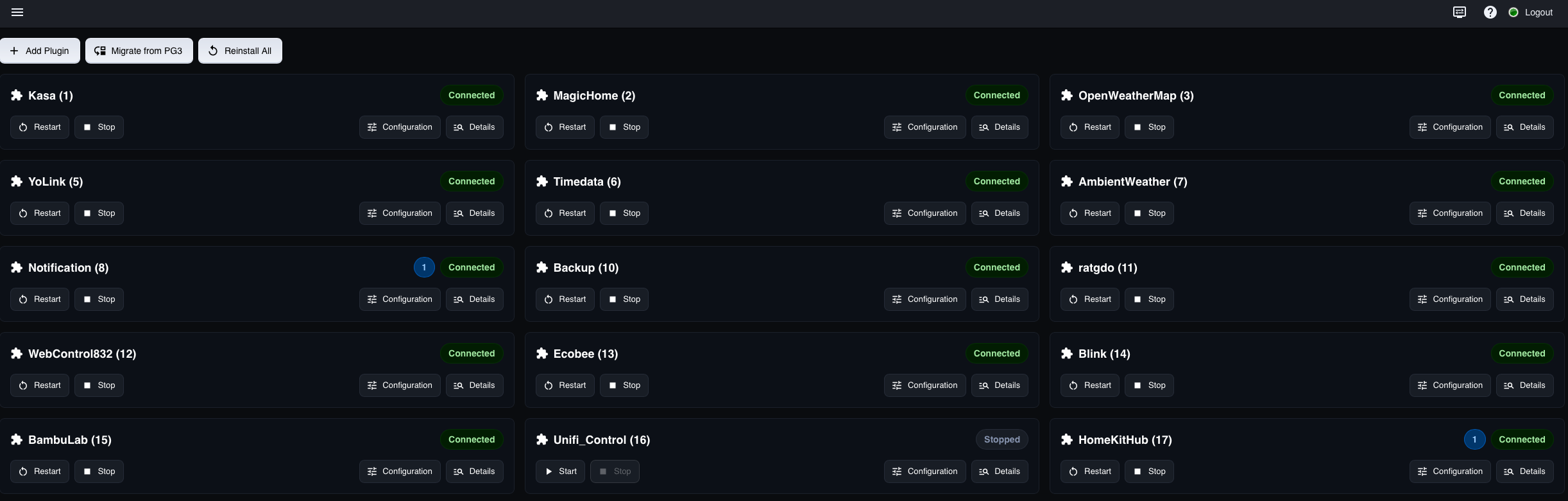

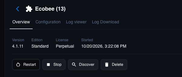

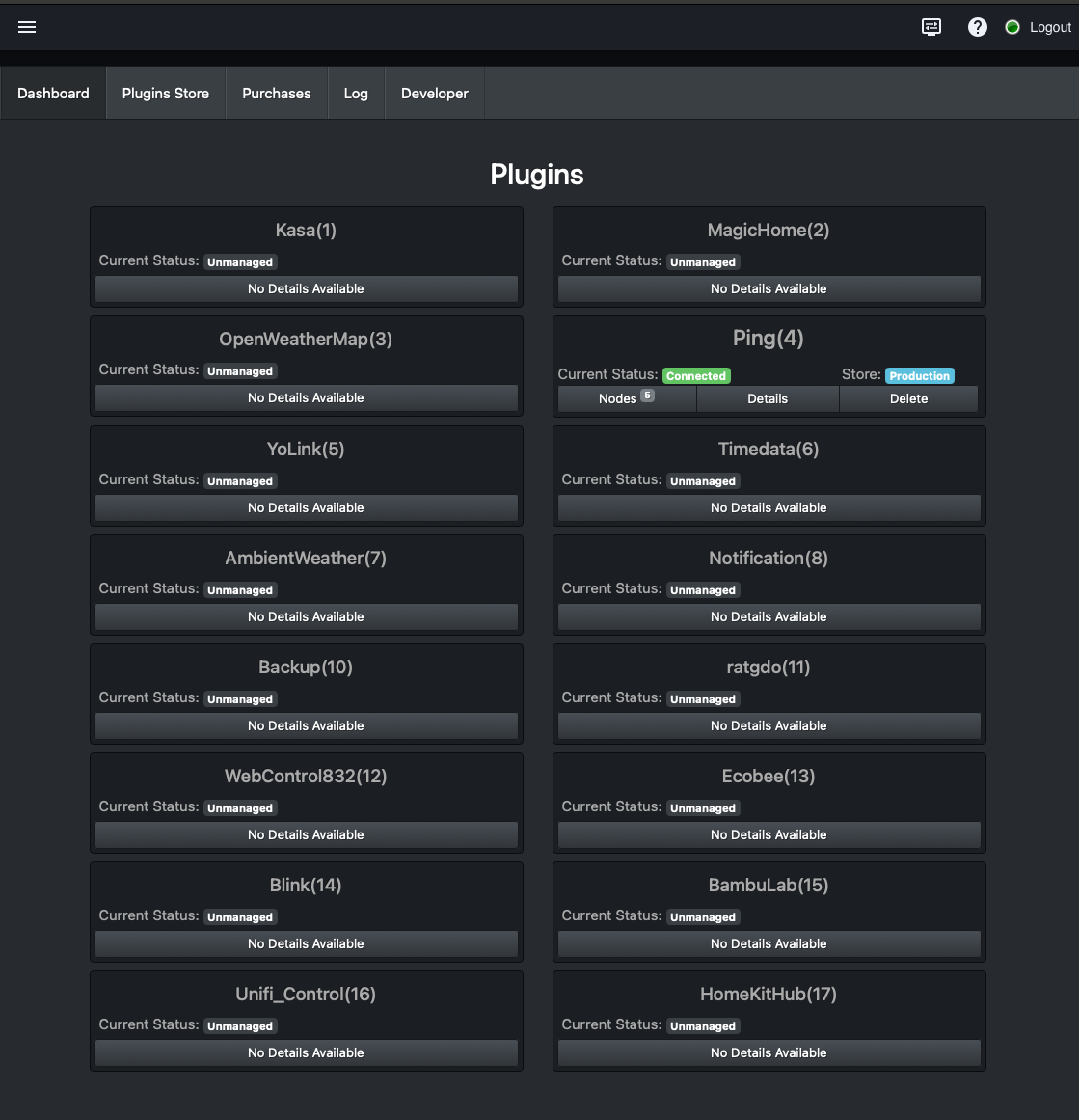

  2. Nope. Not sure where you are seeing that. See attached images: After migrating my plugins I did select the "Remove from PG3" option. Possibly why I don't see the option to migrate back? Also, I tried removing ecobee from eisy plugins and adding it to PG3 but I get an error when trying to add it back to PG3 about read only database or some such. -Xathros
  3. Thanks for your post. I updated but still have the same issue. I have migrated my plugins to the eisy-ui plugins section and that may be the issue. I see no path backwards to PG3 after migration. -Xathros
