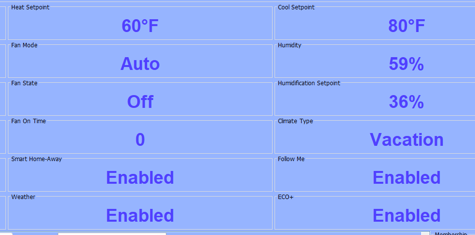

  15. yes, I'm looking for my elk screen to show the status of lights as a percentage but also to have buttons right next to that that will allow me to turn the device on or off.
