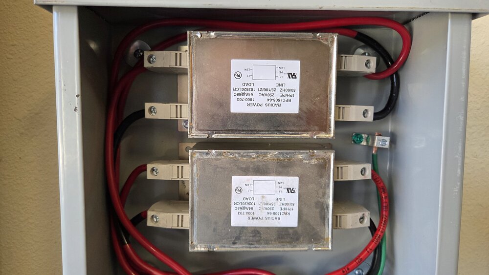

November 11, 2025Nov 11 can you provide a link to the filter you got, and Price for unit and install?
November 11, 2025Nov 11 NCSTATE1978 on page 4 of this disccussion gives an image of the Enphase filter that solved his issues, which were the same as ours (blinking and communication lag)..

November 21, 2025Nov 21 @jkraus I did a little Google search using RPC1508-64. Several good hits. The Enphase page gave me a price around $420. There were some imdependent sources that were around $350 and EBay source in the $230 range. Obviously, there were would be an installation charge and electricians are not cheap.@NCSTATE78 Thanks. Strange that my installer (who does not have a forum id/pw) can no longer see this thread.

December 31, 2025Dec 31 @NightStorm If you "talk" to NCSTATE1978, he will tell you the inline filters completely solved his problem. Right now, my installer (in the DFW Area - Good Faith Energy) is getting ready to install the Ferrite Core solution. I am keeping my fingers crossed. The cost will definitely depend on your installers labor cost. The materials for the Ferrite Core solution are about $400 and the In-Line filter (look in the NCSTATE1978 post for the part number) will run about $900. The in-line filter will require about 3 hours of labor whereas the Ferrite Core labor is about 1 hour. There are some additional materals needed for the In-Line Filter. [Numbers assume a 2 PW3 installation]The blinking or flickering is rather annoying. It only affects my dimmer switch installations. What is really annoying for me is not knowing if the programs will function as they did before PW3. Plus, you can not diagnose anything because the communication timing is all our of whack. I had some earlier Lutron devices, but really was not impressed by them. I am sure they have improved since then. I am considered some of the Z-Wave/Zigbee/Matter devices for outside. However, I really am dependent on scene programming. You can turn off your batteries to make sure everything really is working and perform a diagnosis. Keep working with your installer. Show them this thread. I will say the minute I sent this thread to my installer, it went private or required a login.

Saturday at 02:11 AM4 days We tried the Ferrite Core solution. It helped a little bit. We could see slight improvements on the O-Scope, but the flickering still is happening. Sometimes my scenes works as scheduled. Just completely random. We have ordered the filter that was referenced in an earlier post. The installation is a little bit more involved than the Ferrite Cores. No problems with any electronic devices in the house. TV's, AC units, furnance, tankless hot water heater, Mesh network, internet, ..... are all functioning as expected.You might want to shut your PW3's down. After doing that all of your Insteon and eisys devices should function normally. That will verify the PW3's are interfering with the nornal sine curve of the electricity in your house. Insteon devices according to my conversation with the engineers there like the sine curve to between 59.5 - 60.5 Hz. The stuff coming out of the PW3 was around 62.5 Hz. The only time everything appeared to function normally with the PW3, other than when I shut them down, was when the Severe Weather mode charged all my PW3's to 100%.
