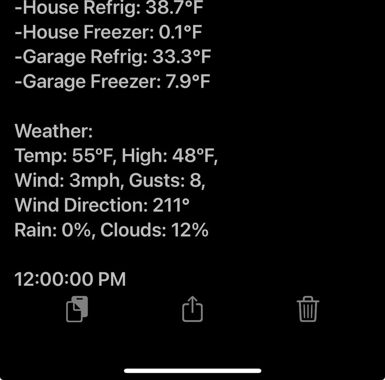

Notification in custom notifications looks like this:
Security: ${sys.node.n014_area_1.ST}, ${sys.node.n014_area_1.GV0}
Doors:
-Front: ${sys.node.ZY010_1.ST} and ${sys.node.n014_zone_1.ST}.
-Mud Room: ${sys.node.ZY011_1.ST} and ${sys.node.n014_zone_15.ST}.
-Back Grg: ${sys.node.ZY012_1.ST} and ${sys.node.n014_zone_12.ST}.
-Mstr Bedrm: ${sys.node.n014_zone_10.ST}.
-Slider: ${sys.node.n014_zone_33.ST}.
-Screen Porch Entry: ${sys.node.n014_zone_5.ST}.
-Screen Porch North: ${sys.node.n014_zone_9.ST}.
-Screen Porch South: ${sys.node.n014_zone_4.ST}.
-S. Garage: ${sys.node.n014_zone_7.ST}.
-M. Garage: ${sys.node.n014_zone_3.ST}.
-N. Garage: ${sys.node.n014_zone_8.ST}.
Main Thermostat:
-Set: ${sys.node.ZY004_1.CLISPH}
-Temp: ${sys.node.ZY004_1.ST}
-Mode: ${sys.node.ZY004_1.CLIMD}
-Status: ${sys.node.ZY004_1.CLIHCS}.
Upstairs Thermostat:
-Set: ${sys.node.ZY005_1.CLISPH}
-Temp: ${sys.node.ZY005_1.ST}
-Mode: ${sys.node.ZY005_1.CLIMD}
-Status: ${sys.node.ZY005_1.CLIHCS}.
Main Level: ${var.1.92} Minutes
Upstairs: ${var.1.94} Minutes
Day 1: ${var.1.98}
Day 2: ${var.1.99}
Day 3: ${var.1.100}
Day 4: ${var.1.101}
Day 5: ${var.1.102}
Master Fireplace is: ${sys.node.1D 5A C0 1.ST}
Water Pump is: ${sys.node.ZY013_1.ST}
Temperatures:
-Outside: ${var.1.28}ºF
-Garage: ${sys.node.n019_ts5.ST}
-Hot Tub: ${sys.node.n016_8b4c01000a1c2e.CLITEMP}
-Mstr Bedrm: ${sys.node.n019_ts4.ST}
-Family Room: ${sys.node.n019_ts1.ST}
-Great Room: ${sys.node.n019_ts3.ST}
-Office: ${sys.node.n019_ts2.ST}
-Lake: ${sys.node.n016_8b4c0100079d9f.CLITEMP}
-House Refrig: ${sys.node.n016_8b4c01000ba53e.CLITEMP}
-House Freezer: ${sys.node.n016_8b4c01000ba56d.CLITEMP}
-Garage Refrig: ${sys.node.n016_8b4c01000ba218.CLITEMP}
-Garage Freezer: ${sys.node.n016_8b4c01000ba4d1.CLITEMP}
Weather:
Temp: ${var.1.28}ºF, High: ${var.1.38}ºF,
Wind: ${var.1.11}mph, Gusts: ${var.1.31},
Wind Direction: ${sys.node.n001_285149.WINDDIR}
Rain: ${var.1.34}%, Clouds: ${var.1.35}%
${alert.time}
Output looks like this
Hope seeing a real life example helps!
