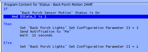

I configured the switch to enable the paddle to be used as a scene button and I confirmed via the button status that a double-tap is indeed recognized as "Fast On" (and that the light doesn't actually turn on). However, when I insert that into my program, either directly or as a variable, the program doesn't work (motion is not detected). I'm attaching a simplified version of the program that I'm using to test.

So before you added the "And $State_5 is 1" line, this program did correctly work each time that motion was sensed, correct? The only change you made was adding the line "And $State_5 is 1"?
And if the answer to the above question is yes, can you confim that the current value of $State_5 is 1?
Posted
Answer to your first question is yes. It did/does work without this line. In fact, this is a copy of the program with a lot of the bloat removed just to facilitate testing.
Yes, value is 1.
