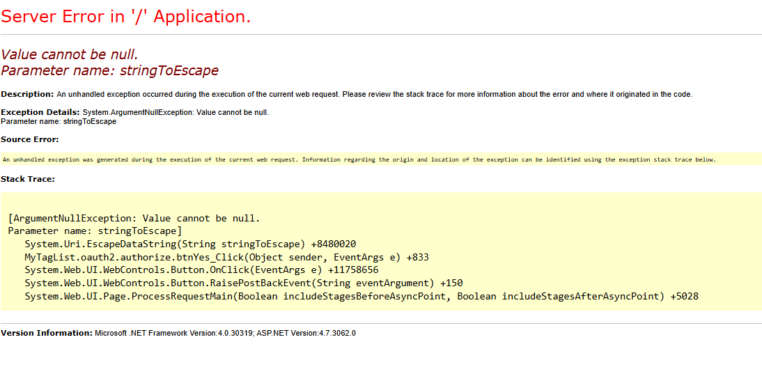

When I go to details in the node server in pG3 there is a blue box that takes me to a browser to grant access for wireless tag to PG3.  I click the button that says to give UDI access and that error page pops up.  I’ve tried this on two different computers and three different browsers.
This issue has been reported to wireless tags by myself and another developer and they claim there's no issue. I will have to deauthorize mine to test and risk not being able to authorize again... Support from that company has gone from bad to worse.

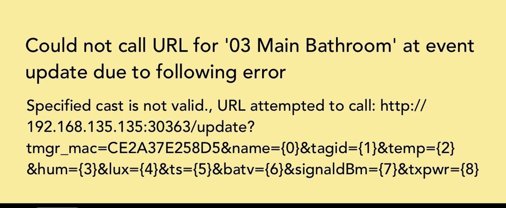

I also get the same error. But I've also been receiving some error notifications from the WirelessTag app for a little while. I can't find one right now but will add the details here once I get a new notification, in case it might help identifying the source of the issue.
Hi @Jimbo.Automates,
I finally managed to catch the full notification I get from the Wireless Tag app. (following image).
I don't know if it can help you, but the IP address in the attempted URL call is my Polisy.

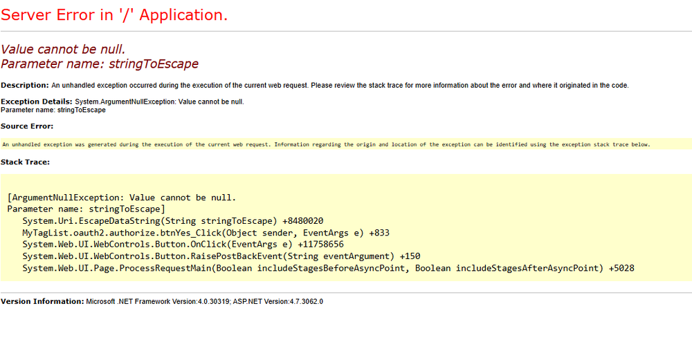

Receiving the same Server Error / in Application trying to authorize wirelesstag node server
Both when I attempted the trial version as well as the full version I just purchased $30 but cannot get working due to this error.
