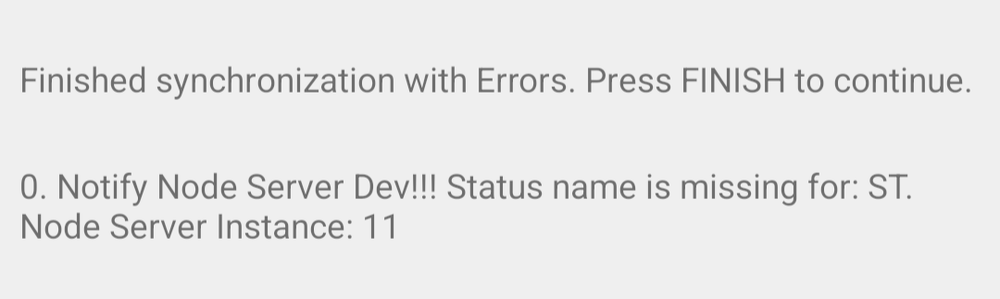

Hi, I'd also like to thank you for all your work with this. Regarding--
"By request I changed behavior of ST and added a GV30 variable to all nodes - GV30 is the existing ST (mostly if node is online) - Changed ST to show the most relevant parameter of the node - this is to support udiMobile status icons (they trigger of ST parameter)  - I hope that it is not too big a problem as some code may need to be updated if programs tests for online status"
--when I sync with UD Mobile I do get errors:
0. Notify Node Server Dev!!! Status name is missing for : ST. Node Server Instance: 11
1. Notify Node Server Dev!!!  Status name is missing for: nlshub. Node Server Instance: 11
I have no idea what this means or if it's related.
seems there is a bug in the config file for normal hub (i did not test that as I use a different hub)
i'll release a fix shortly  - hopefully that is the only one

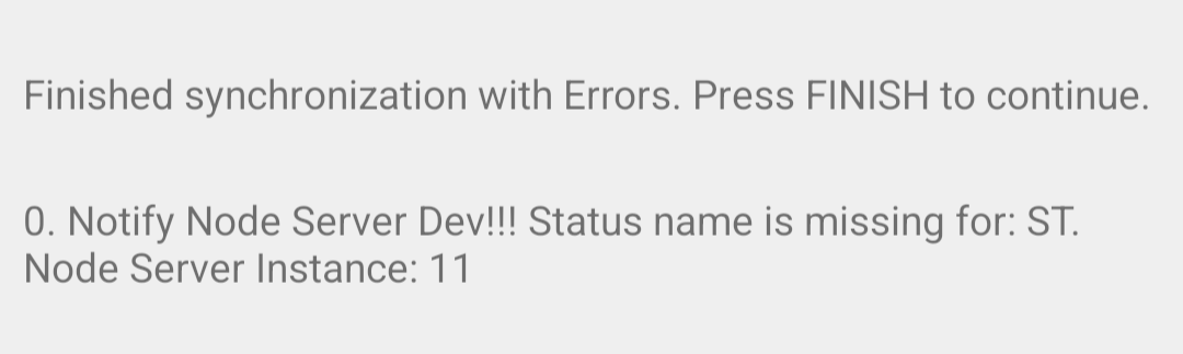

Receiving this error:
--when I sync with UD Mobile I do get errors: yolink 1.6.2
0. Notify Node Server Dev!!! Status name is missing for : ST. Node Server Instance: 6
Anything to worry about. Everything seems to work fine??
I think I found the issue - at least my current version (internal) does not show this - I am working on another bug I want to fix at the same time - The above is more cosmetic - there should be no functional issues
