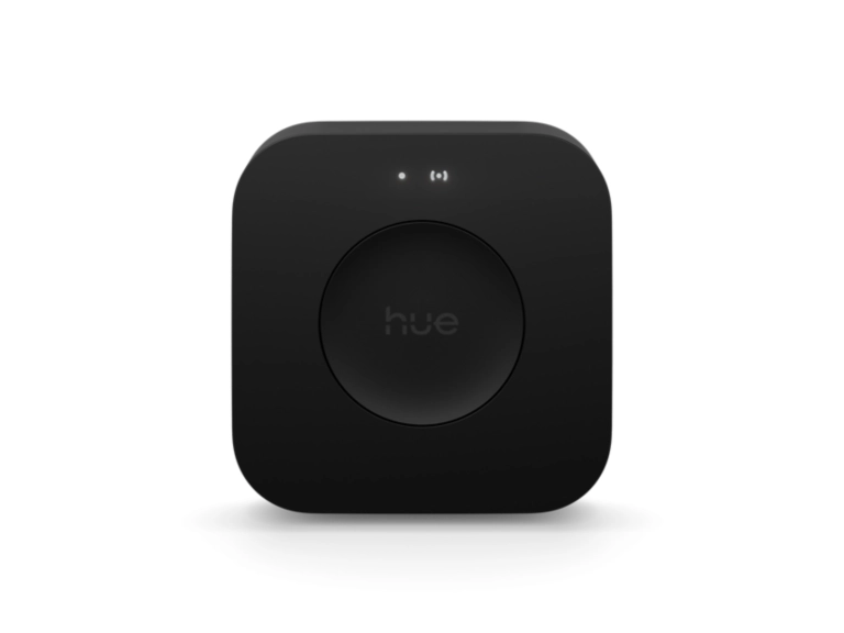

Hello all,
Well, the Hue saga never ends with me obviously.  I just updated to the New Black Hue Bridge Pro, and as you can see below, I am having nothing but problems getting it connected or even finding it.  I've done all the steps I've done previously with no luck.  Can someone let me know if the New Bridge Hue Pro works with the current plug-in.
Solved by Geddy
1 hour ago, GSutherland said:
Hello all,
Goodness Mr early adopter... How is the bridge outside of the system? Do you notice a difference? Have you tried to see if network resources work with it?
I've noticed the bridge is really faster than the previous in response to my iPhone control for all my whole house network and also I feel like it reaches farther so I don't have lights on the outside of the perimeter having issues.  It's nice to have Wi-Fi and wired built into it....... and the amount of lights you can add to. It's pretty impressive cause I'm at 49 went away from the previous one that would not take anymore. This one I believe goes up to 150.
Seeing that the hue plugin was developed on unofficial api (based on previous posts about this plugin) and hasn't been updated in a while (years?)...I would hazard a guess that the "pro" hub is not supported. If you tried all the usual tricks and still cannot get it to connect, it might not be using the same methods that the plugin is using to identify and communicate allowing successful connection.
Fun that there's a new hub for hue.
I remember that the Hue api for a long time has been "version 1", and that they introduced a more secure version 2, hinting that version 1 would eventually be unsupported. Maybe that was the reason for requiring that you now log in to your Hue account on their phone app. If that's the case, then the plugin would need to be rewritten to use the newer api.
Following this thread, my Hue Bridge Pro arrives shortly. I will let you know if I find a method that works!
A quick search turned up this AI answer:
"No, the Hue Bridge Pro does not support the deprecated V1 API; it requires the V2 API to function".
So that's that. You might need to access your Hue devices as Matter devices instead, which the new bridge supports.
Question....
Hue devices use Matter that the new bridge supports V2 API
But can I use Matter on the EISY to add and program HUE control my lights
Or should I wait till a New Version API that support hue again on EISY NODES
thanks
I doubt that someone will rewrite the Hue plugin to use the V2 API. I'd try Matter, which is still in beta on the eisy. Matter was specifically created to allow interoperability between systems, and this is a good example of that. You'll probably get the basic functionality, minus some of the fancier features.
Question, how should I start setting up matter in order to start reading the Hugh because I'm having no luck in finding it
Same problem, same question, but with some success.  I enabled Matter in the config screen on EISY.  Then went to the Hue App/Setting/Smart Home/+/Other Apps and got a MATTER Pairing Code.  I went to the UDI app/Matter/Add Device and entered the pairing code.  I now have my Hue Bulbs (unnamed) as "ZM 002.# On-Off Switch" which gives me basic on/off functionality.  They come on in the last color I set.  This doesn't really work for me as I need to be able to select hue scenes with effects and colors.  I don't really need direct control over color.  I'm wondering if scenes are exposed in matter and might be supported in the future.  Having the names come through would also be nice, or a new Polyglot plug-in.
Edited by Lore

It thinks it found your bridge at 192.168.1.46 - does this address look correct? Can you SSH to eisy and do like:
curl -kv https://192.168.1.46/api -d '{"devicetype":"polyglot#huev2", "generateclientkey":true}' -H 'Content-Type: application/json'
ideally you should see an error that button was not pressed:
[{"error":{"type":101,"address":"","description":"link button not pressed"}}]
Nope, not my right IP address. Here is a screenshot of my info.IMG_5742.HEIC
hope this helps.....
Well, I have great news. It worked perfectly had me push the button. I restarted it like typical and it populated everything I wanted to send you a screenshot of what I set in the settings because single hash marks will not work and I sent you the logs also to help you see what was happening in the background.
