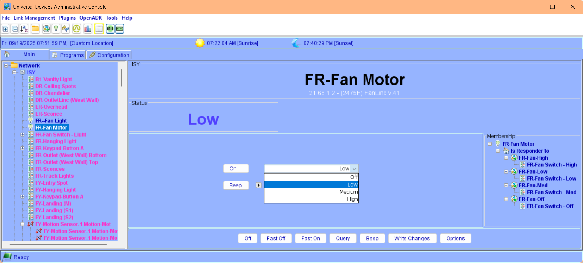

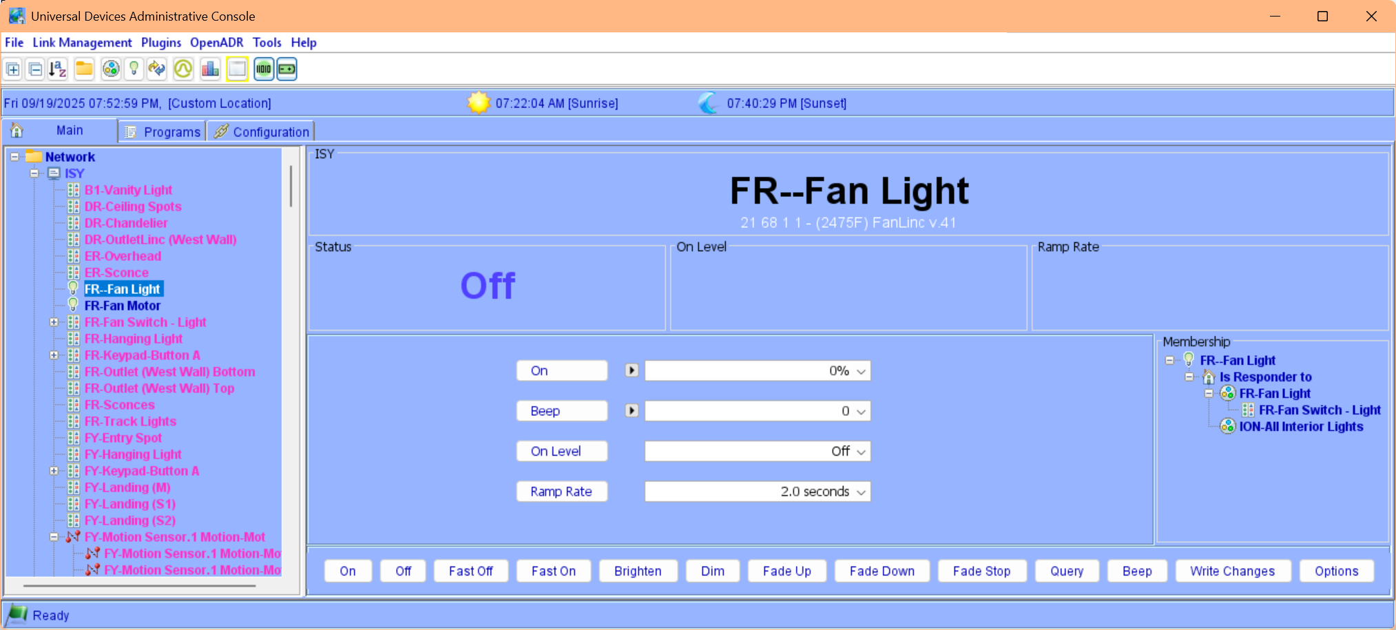

Yes it's supported. It appears as two nodes: one for the light and another one for the fan. Both appear as dimmers. The fan physically has 3 speeds, and setting a dim level will select one of the three. If I remember right, 50% or more will select the high speed. 25% to 49% will be medium speed, 1 to 24% low.

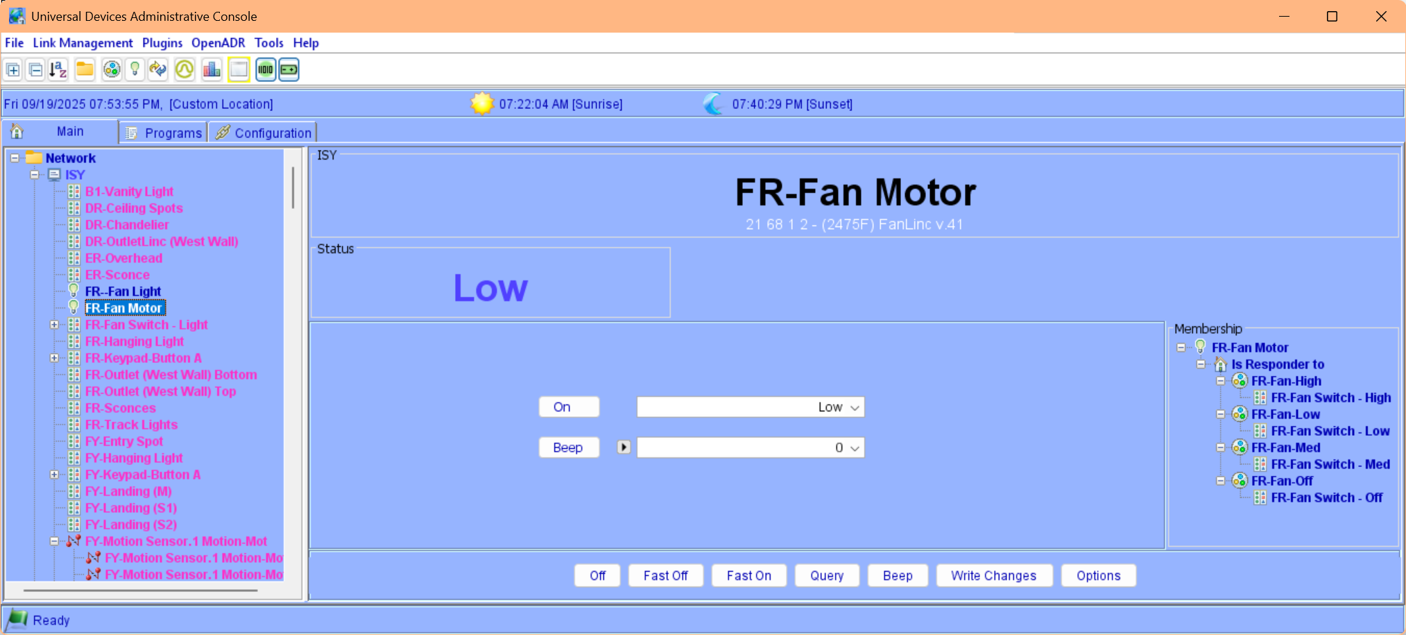

Thanks, that's very helpful.  Controlling the fan speed as if it was continuously variable is strange, but sounds like it works.  I do see high, medium, and low in the picture, so that is encouraging.  I think I will give one a try.

I've neve set them as % ranges. The buttons on my keypad are set to High/Medium/Low settings. Then there are scenes that have that. Sadly, because IoX just estimates scene settings in UD Mobile sometimes it just shows the percent (for the fanlinc motor, but the scene for the speed will be active. I don't worry about it. Our fans are usually voice controlled through Echo to change speeds. As long as you have the motor setup as a fan in the portal it works just great. I use programs to keep the keypads in sync (again, goes back to how I set things up originally).
